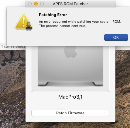

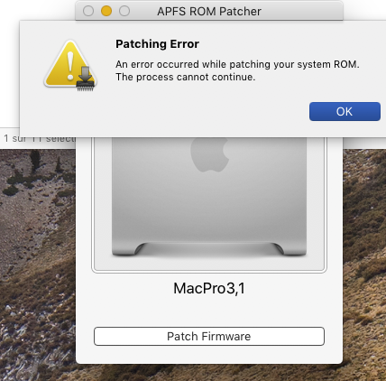

Re-install Legacy Audio Patch using Patch Updater.
Thanks Dosdude1. I try to run it again and I got this message. So I cancel and it looks it will not be possible on my MacPro 3,1 ??????????
