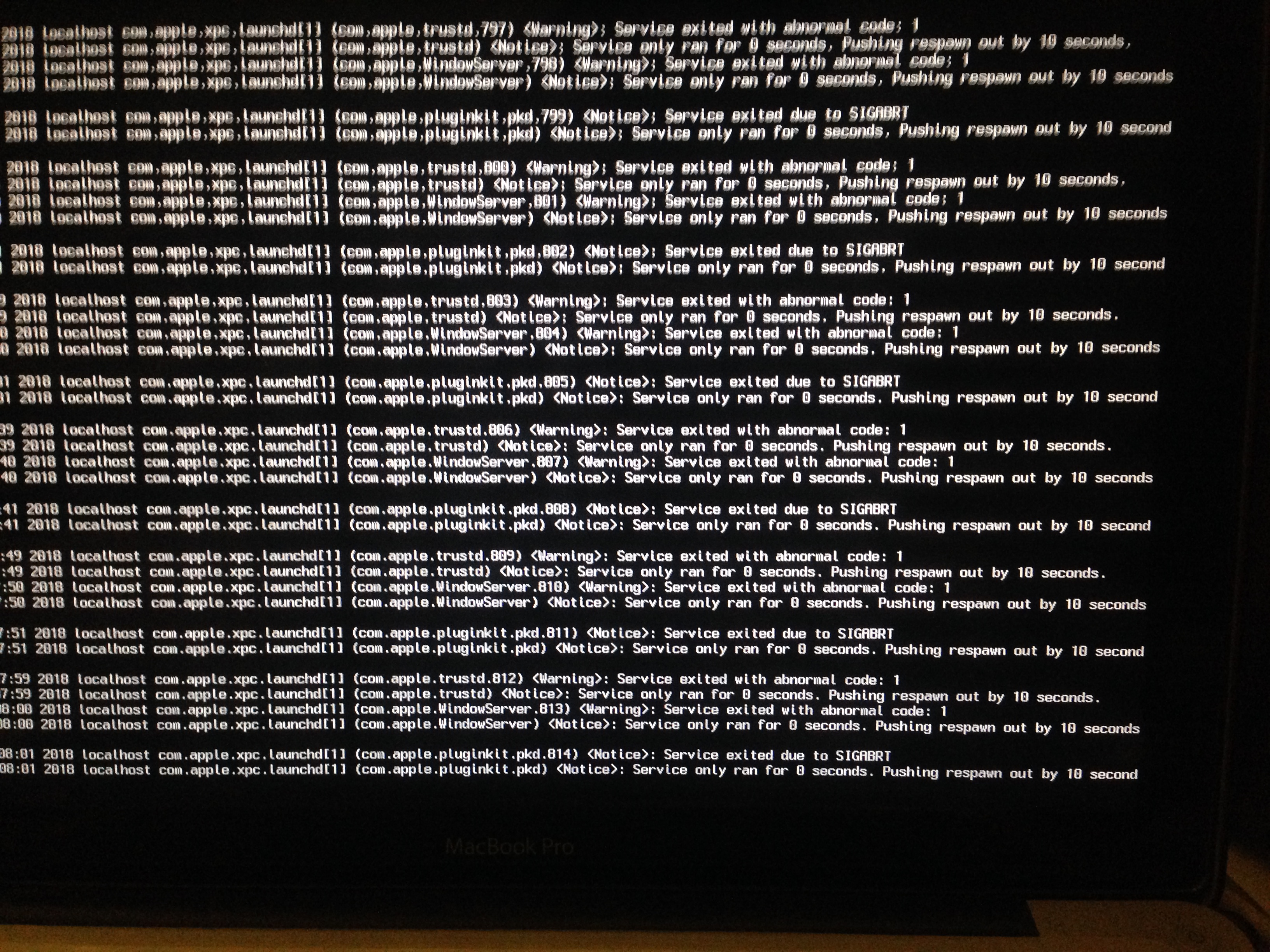

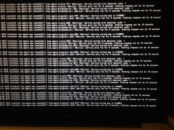

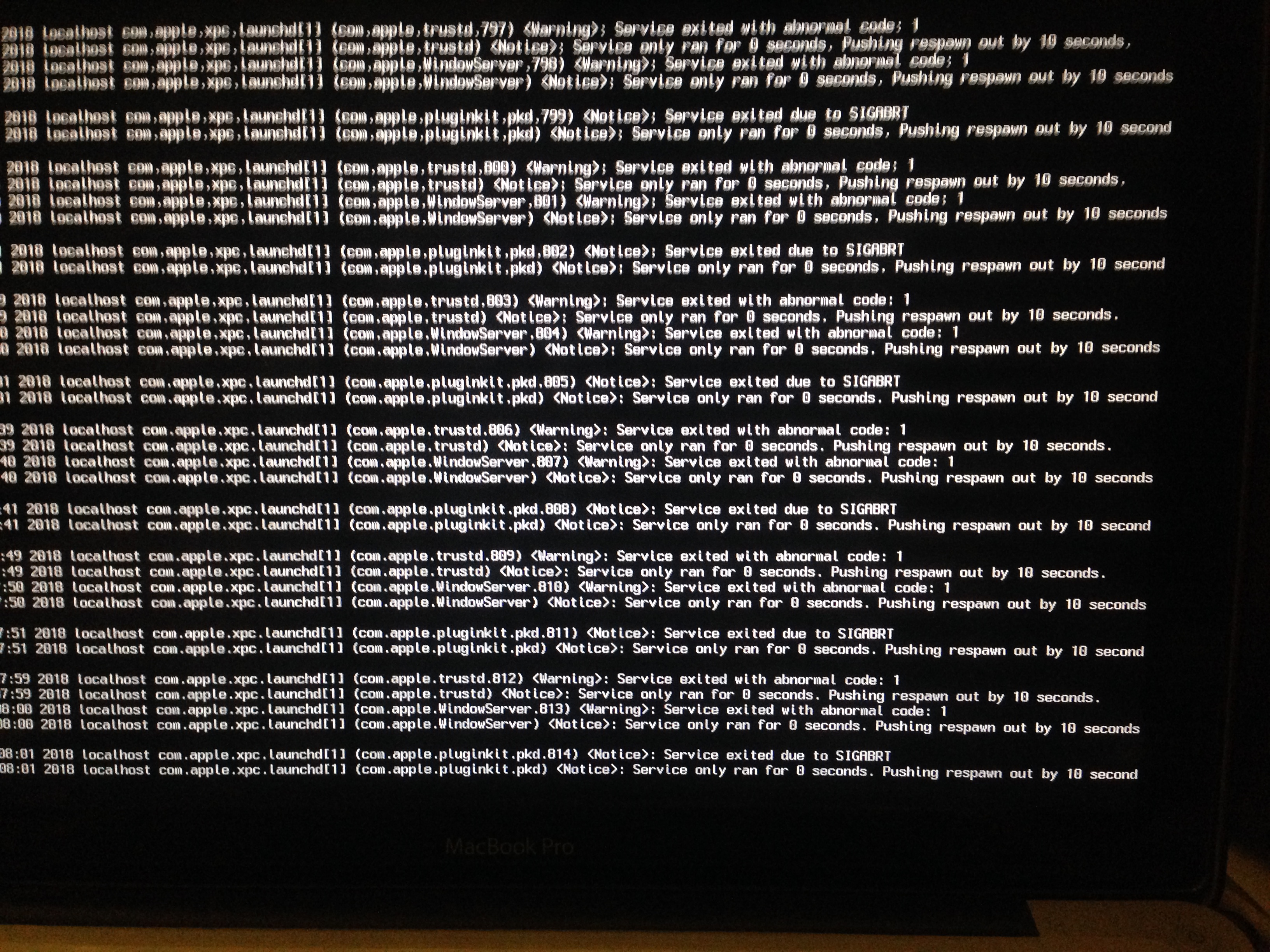

Take a video or a photo of where it gets "stuck" and post it here.
it keeps saying the same message but with different numbers (I let it run for like 15 mins or 20 mins)... I let it previously run for two hours but not in verbose mode and it did not open.
Reactions: TimothyR734
So basically some of the LaunchDaemons on your boot drive are crashing repeatedly. The system keeps starting them but they keep crashing. That's not something that's super easy to trace unfortunately.
This is a USB made with dosdude1's tool, correct? Please try recreating it. It's quite likely that something got corrupted or the permissions are wrong.
Yes made by dosdude1, I recreated it many times but all the same... I don't know where is the problem. I am using the latest patch 1.2.3
Should I change the USB? should the usb be formatted in GUID instead of MBR?.
I fixed it,
Replaced the USB, used patcher 1.2.1 and put the patcher and Mojave installer in one file and tried it.
Thanks for your concern I really appreciate it 🙂.
