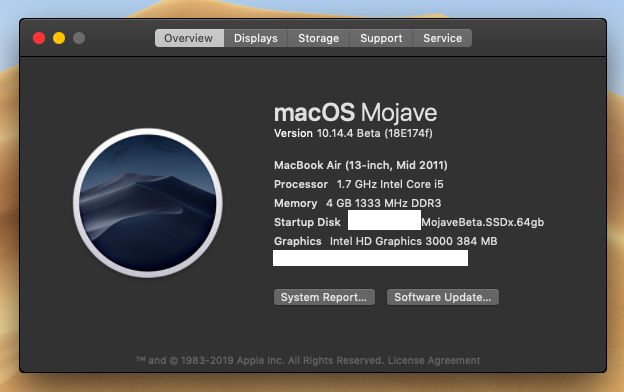

Now I am able to login to my beta 10.14.4 MBAir, 2011 by renaming the bundle file.
You also mentioned "without acceleration". How can I verify or test the effects of "no acceleration"?
A couple of observations:
  1. Verified that I do not have acceleration.
  2. Running @dosdude1's patch updater reset or setup the HD3000 GL Graphics bundle again. Thus failed to boot. Renamed the bundle folder again and now boots.
You guys think that on the next beta (2) that these anomalies will be fixed? Thanks.

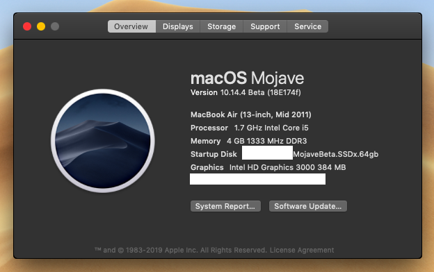

We will see, @ASentientBot has quickly discovered a good workaround excluding the OpenGL kext, so even if less usable w/o acceleration at least Mojave still boots on 10.14.4.

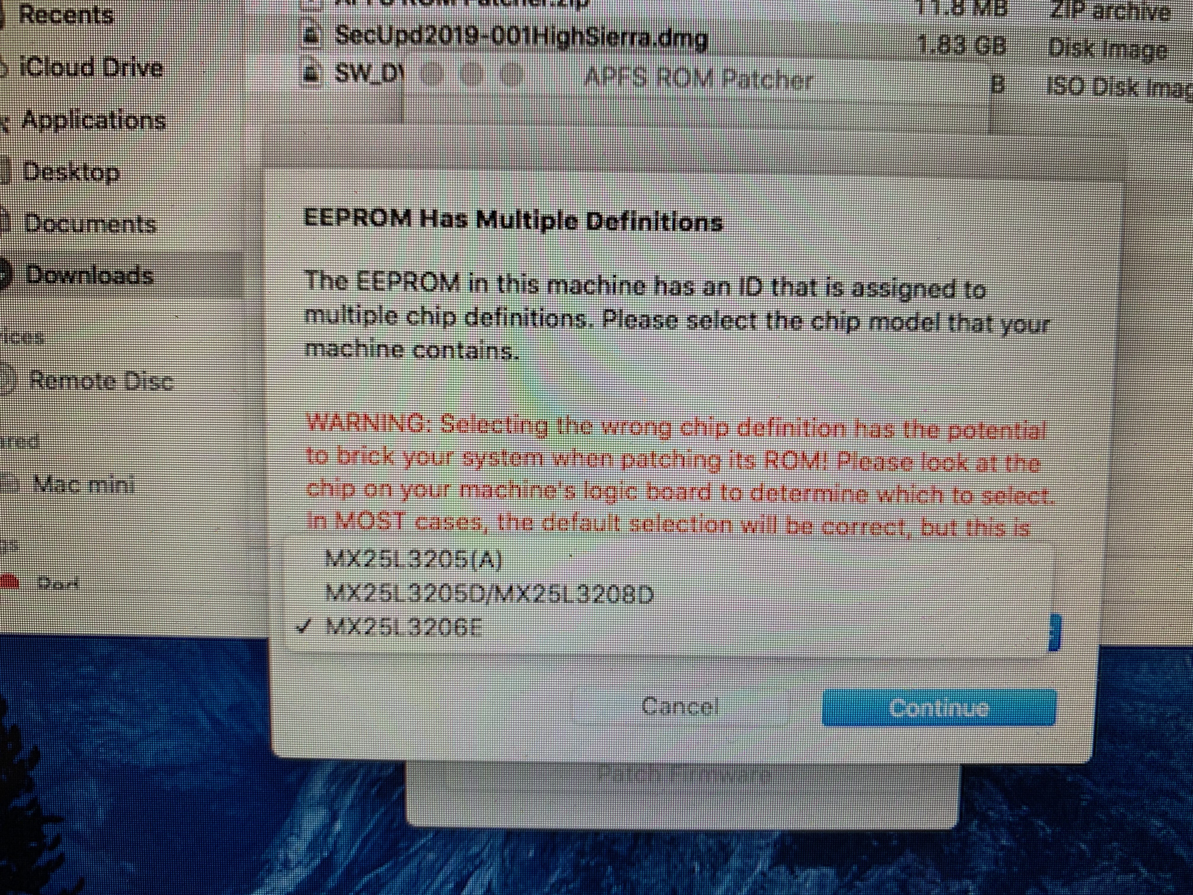

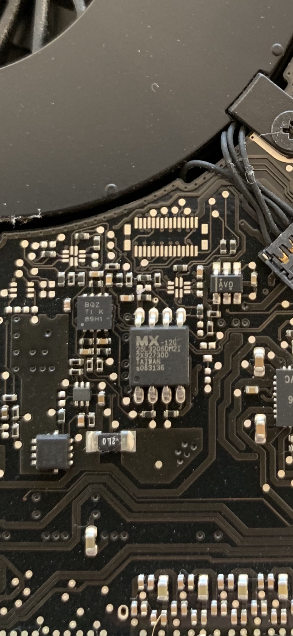

One last thing, when using the APFS ROM patcher I had to choose a different EEPROM to the one suggested but it worked fine once I opened up the case and found what it was. See attached images.

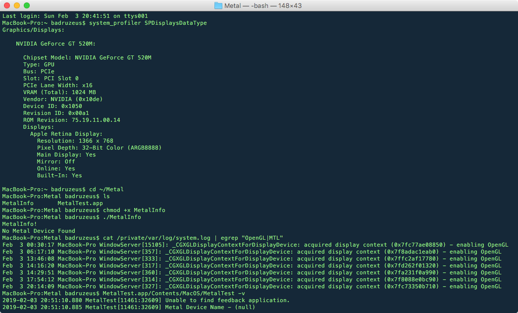

Yeah, Fermi is bit complicated GPU; Apple's SysInfo said it's Metal Supported one; but OpenGL Extensions Viewer (among many other apps) on the contrary said it doesn't. I'm pretty sure it doesn't.. at least from this MetalInfo.app test.
Anyway, as a workarround for dependencies problem ["Too many corpses being created blah blah blah.."] using diff. frameworks from another macOS version (can't quarantee this will work on your case):
