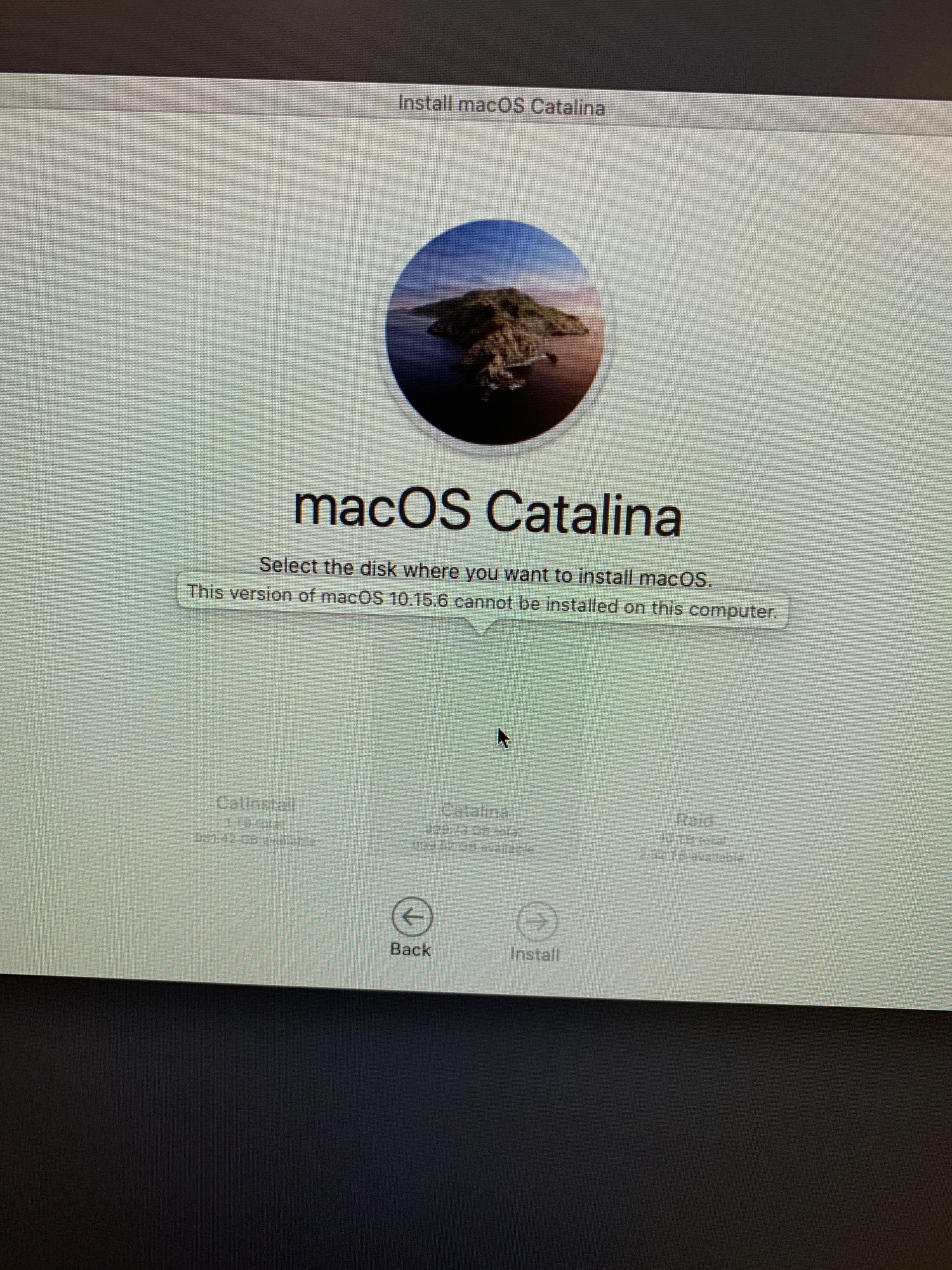

I made it to the Install page, but I'm getting a "This version of macOS 10.15.6 cannot be installed on this computer" when presented with list of drives. The SSD was formatted APFS.
I'm using a cMP, 4,1 upgraded to 5.1.

Installing dosdude on a 2009 4,1 -> 5,1 cMacPro, this is as far as it goes. SSD has been formatted to APFS.
