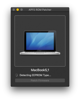

On this windows for 10-15 minutes, how long it take usually, any idea?
Reactions: TimothyR734

That's a MacBook6,1, which supports High Sierra, and therefore APFS booting, natively. I'll be updating the tool soon with a software APFS-booting implementation for machines that don't support doing so natively, once I get it all worked out.
i thought there wasn't anyway for the post-install patcher to detect when the APFS ROM patch was applied to an unsupported Mac or have you puzzled that out?
[doublepost=1562092465][/doublepost]
A very long time, sometimes almost an hour. Just do NOT quit the program, let the machine go to sleep mode, or turn the machine off, otherwise it will brick your system.
Although sometimes it can be surprisingly fast. On my MacPro 3,1, the APFS ROM patcher applied in less than five minutes.
