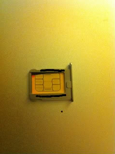

That's not my card. I just took arn's pic and annotated it 🙂
Ah, gotcha. Ok, but the information is still valid. 😉 Apparently arn has used that SIM for some time in some different devices, I'd guess based on that level of wear.
I am reporting an all new theory about the AT&T iPhone SIM cards. I like to call it the "tooth" theory. In the first image below, you can clearly see that my SIM card has five teeth, with one empty space where a sixth tooth should be.
The solution you ask? Well, it's simple. Either draw in your own tooth as I did (see second image) or make an appointment with your dental surgeon for first thing in the morning. Either way your iPhone 4's reception will be magically restored in a revolutionary way.

I've been saying since day one (June 23rd), my iPhone4 does not have reception issues. For the sake of comparison, here is a pic of my SIM, not touching.
Nice macro shot, thanks. Interesting SIM there, never seen one so exposed like that (meaning it doesn't seem to have as much plastic acting as an insulator between the contact pads like pretty much all other SIMs do. Was that a factory microSIM or one that you've had for some time now used in other devices, etc?
The wear level (the scraping) on it seems pretty high as well...
nope. that sim came with the iPhone 4.
My SIM does NOT look like that. I got 99 problems and touching my lower left seem is one.
Mine is lower and touching the SIM tray.
