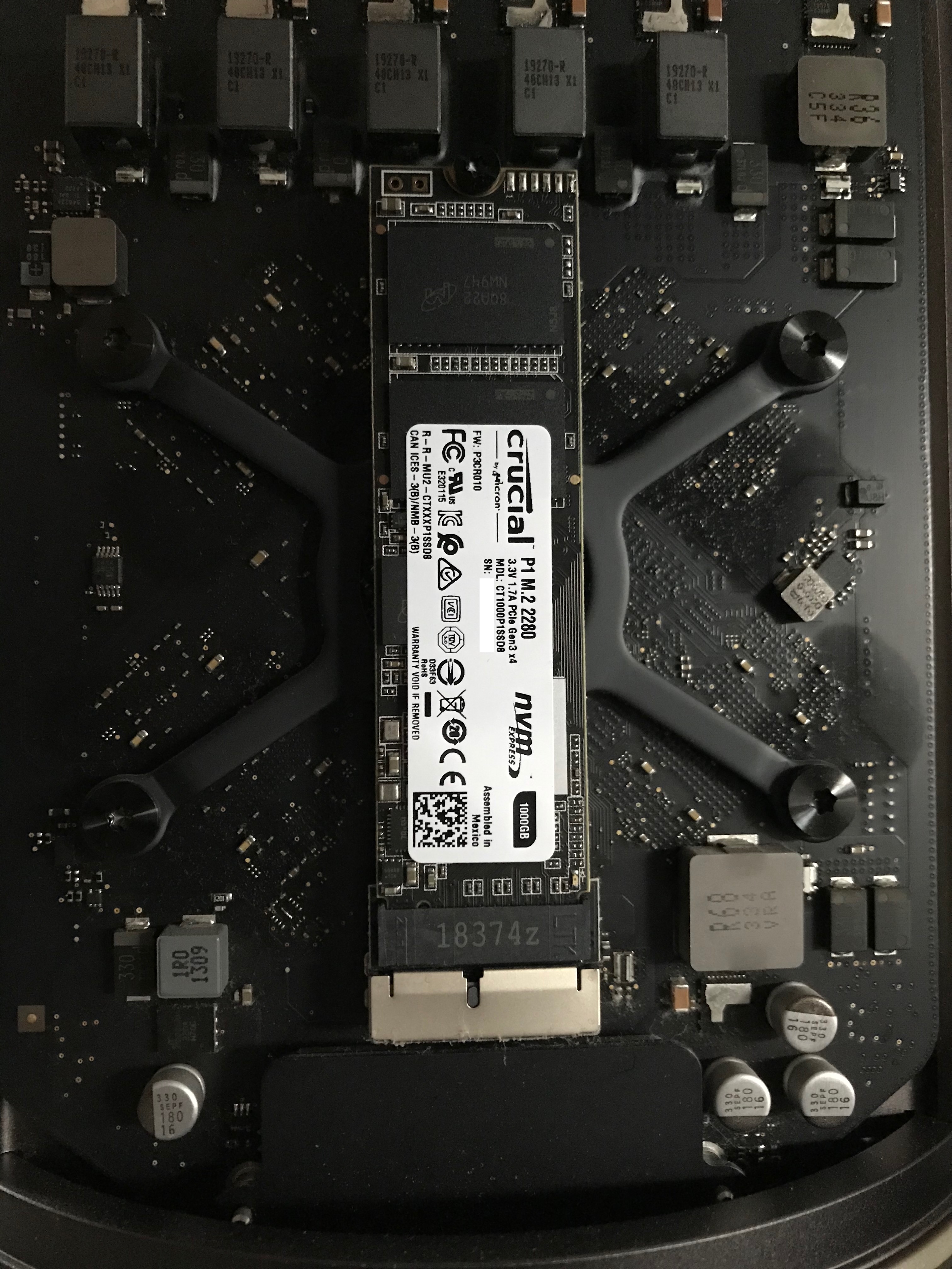

A few days ago I installed the following Sintech adapter in my Mac Pro 2013: http://eshop.sintech.cn/ngff-m2-pcie-ssd-card-as-2013-2014-2015-macbook-ssd-p-1139.html
Normally I wanted the adapter: http://eshop.sintech.cn/ngff-m2-pcie-ssd-card-as-2013-2014-2015-macbook-ssd-p-1229.html but it was not available in the moment here in Germany. The seller told me that they are electrically the same.
I installed the adapter together with a Crucial P1 with 1TB (CT1000P1SSD8). I used this slower NVMe SSD because the port in the Mac Pro 2013 is not so fast that it takes advantage of a faster one.
Before I had a SSUBX 512GB from Apple (SM0512G) that writes with 1054 MB/s and reads with 1410 MB/s.
The Crucial now writes with 1227 MB/s and reads with 1448 MB/s. So everything is fine, it is fast and I have more free place.
I have no problems with sleep or any other glitch. It is simply great!
After updating the original Quadcore to a 10-Core this was the best update so far!
Here is a picture showing the SSD in the small adapter inside the Mac Pro:
