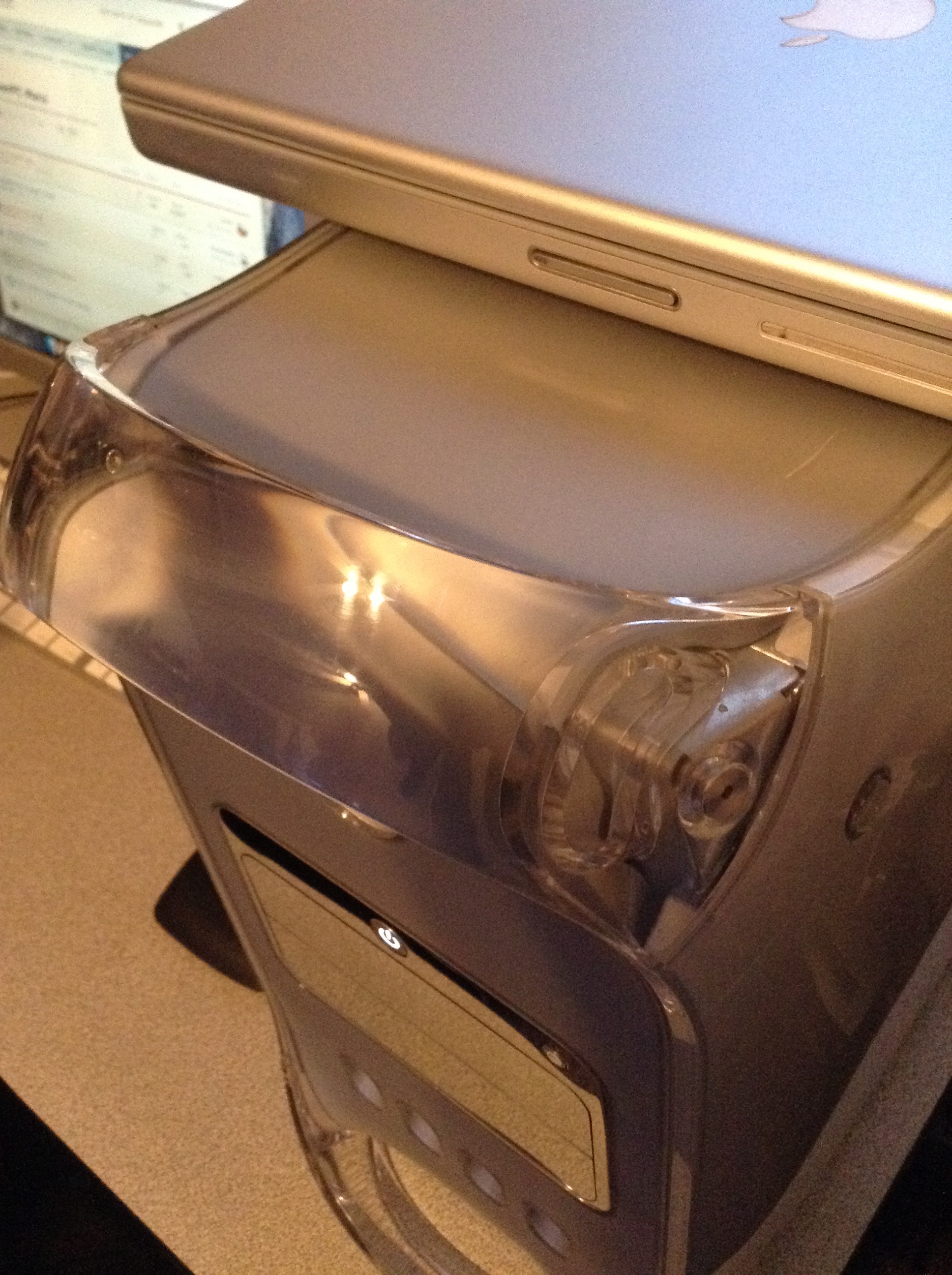

I can vouch for the "Novus" product as shown here.
Used it to clean up the very badly scratched up handles on my G4MDD.
