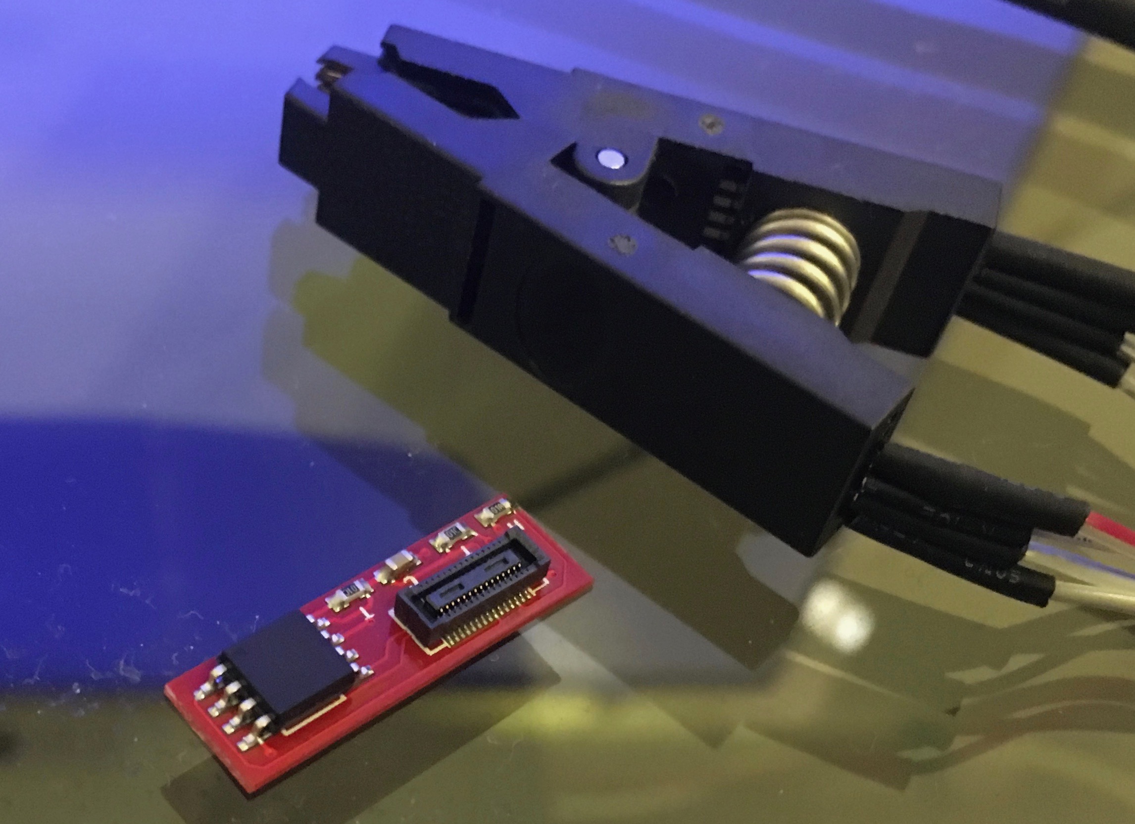

Hi everybody,
I've recently discovered this thread which made me decide to upgrade my 2013 macbook air with an intel 760p drive.
I could have lived very well without the possibility to put the mac to hibernation, but unfortunately the battery drain during sleep varied massively. Sometimes, it took 3 % overnight and sometimes it took 50 %, which was rather annoying - especially since I travel a lot and like to have at least some reliable standby.
Therefore I looked for easy options for a bootrom update and tried the approach that was already proposed a few months ago by vk2fro which basically contains of using a small piece of hardware that plugs into the diagnostic port on the logic board. I did not choose the one from macunlocks, but rather a "matt card", which can easily be flashed by using a SOIC8 clip. Everything else I did as described by gilles_polysoft, i.e. using UEFI tool to merge the NVMe driver from a newer firmware into my mac's firmware and afterwards flashing this firmware to the matt card.
Long story short: it worked as expected, can easily be undone/redone with newer firmware if needed and the risk of bricking the mac due to mistakes when accessing its original rom chip is basically non-existent. On the con-side, of course it was an additional cost of 60 EUR for the matt card...

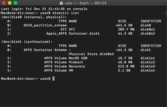

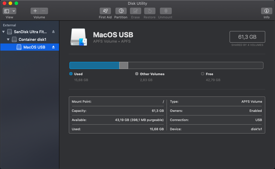

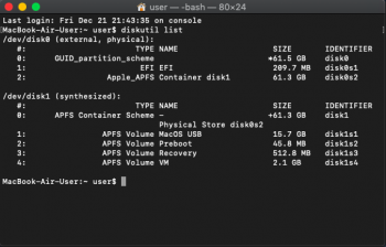

Is it shown in command line, e.g., typing 'diskutil list'?
I've tried to, but it doesn't appear in disk utility at all, as well as in device manager when I boot into macOS from a usb.
SSD is 100% working - tested on a PC and in a usb-to-m.2 adapter.
Please post a screenshot of Disk Utility.

Hi everybody,
Thanks again for this interesting thread, especially to gilles_polysoft for figuring out the details of the NVMe driver in the bootrom and dosdude1 for his ROMTool which also was very helpful.
Interesting. How did you write the modified bootrom on the Matt card? Was any special hardware except an SPI programmer needed? For the programmer I plan to use a Raspberry Pi.
An SPI programmer is sufficient - I also used a raspberry pi.

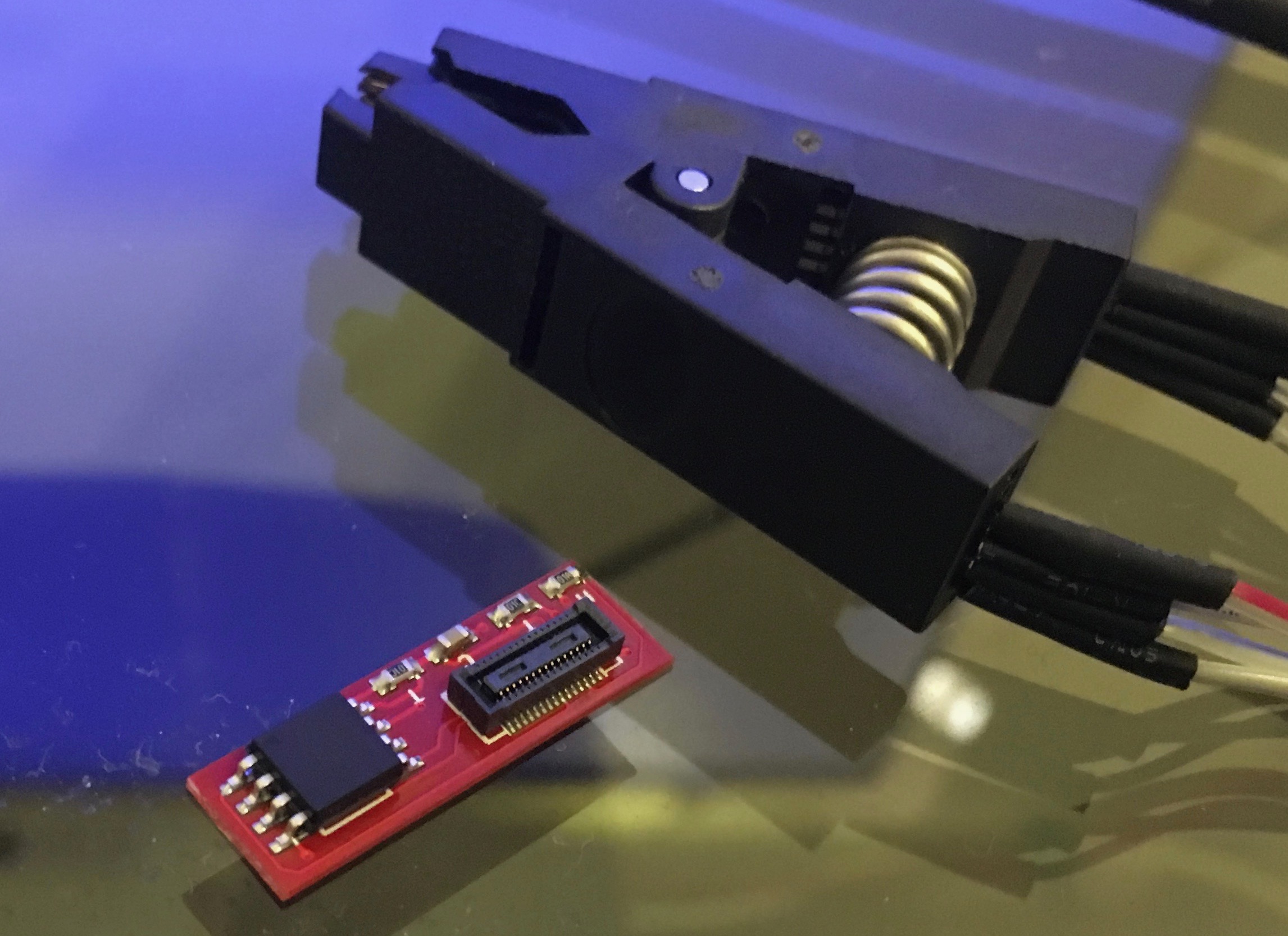

Is there some sort of documentation how to do that?
Do you mean the preparation of the modified bootrom image? Or the flashing of the matt card? Or the entire process?
I do not have a fully fledged documentation, but I'll link my main sources below (with the most important one being of course this entire thread):
- General SPI programming using a raspberry pi: There is quite some information out there - I just googled a little and read several pages regarding this topic. This guide boils it down to the most important steps required here: https://www.rossmanngroup.com/board...ite-erase-apple-efi-spi-rom-with-raspberry-pi. Since I assume you speak german, this page contains some more general information about the SPI interface of the RPi and might be helpful to get a better understanding of what we are actually doing here: http://www.netzmafia.de/skripten/hardware/RasPi/RasPi_SPI.html
- Modifying the bootrom: As written above, I mainly followed the procedure described by gilles_polysoft in this post https://forums.macrumors.com/threads/2034976/page-52#post-26067118. I only replaced the direct J6100 connection to the logicboard with a SOIC8 connection to the chip on the matt card - in the image below you can see that it is very well accessible on such a card.
