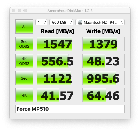

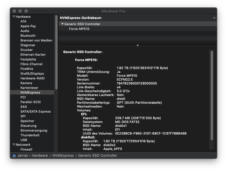

Hi, tnx for this tread and all that contributed. I was able to upgrade my MacBook Pro Late 2013 with this information successfully. Attached the (german) screenshot of the system information on NVMExpress.

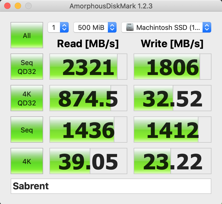

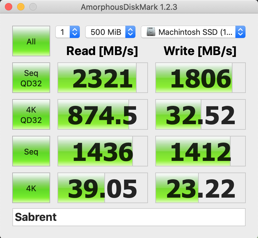

I bought my Sabrent 2TB Rocket from Amazon last June (2019) and it is still working great. I just took this benchmark right now and I'm on the latest Catalina. Haven't had any issues at all. I wonder if people are using questionable adapters which make it appear that the drives are problematic.

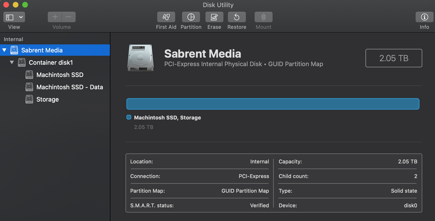

What adapter are you using (link please)? Does the drive give you 2048GB of usable space when you look in Disk Utility? (2TB drives give 2048GB, 2000GB, or some as low as 1920GB of user space)
The adapter was one of the ones that was recommended. I can't tell you which because I bought 4-5 of them at the same time since it appeared some were not good. If you search my posts in this thread, I think I shared my findings on those adapters and I think I said which one I used. It was the first one that I used which is the one I stuck with.
Here, I found the post where I shared what adapter I'm using here. Looks like the Sintech: https://forums.macrumors.com/thread....2034976/page-183?post=27450743#post-27450743
Here is the current info from Disk Utility. Hope this helps you...
Reactions: powerslave12r
