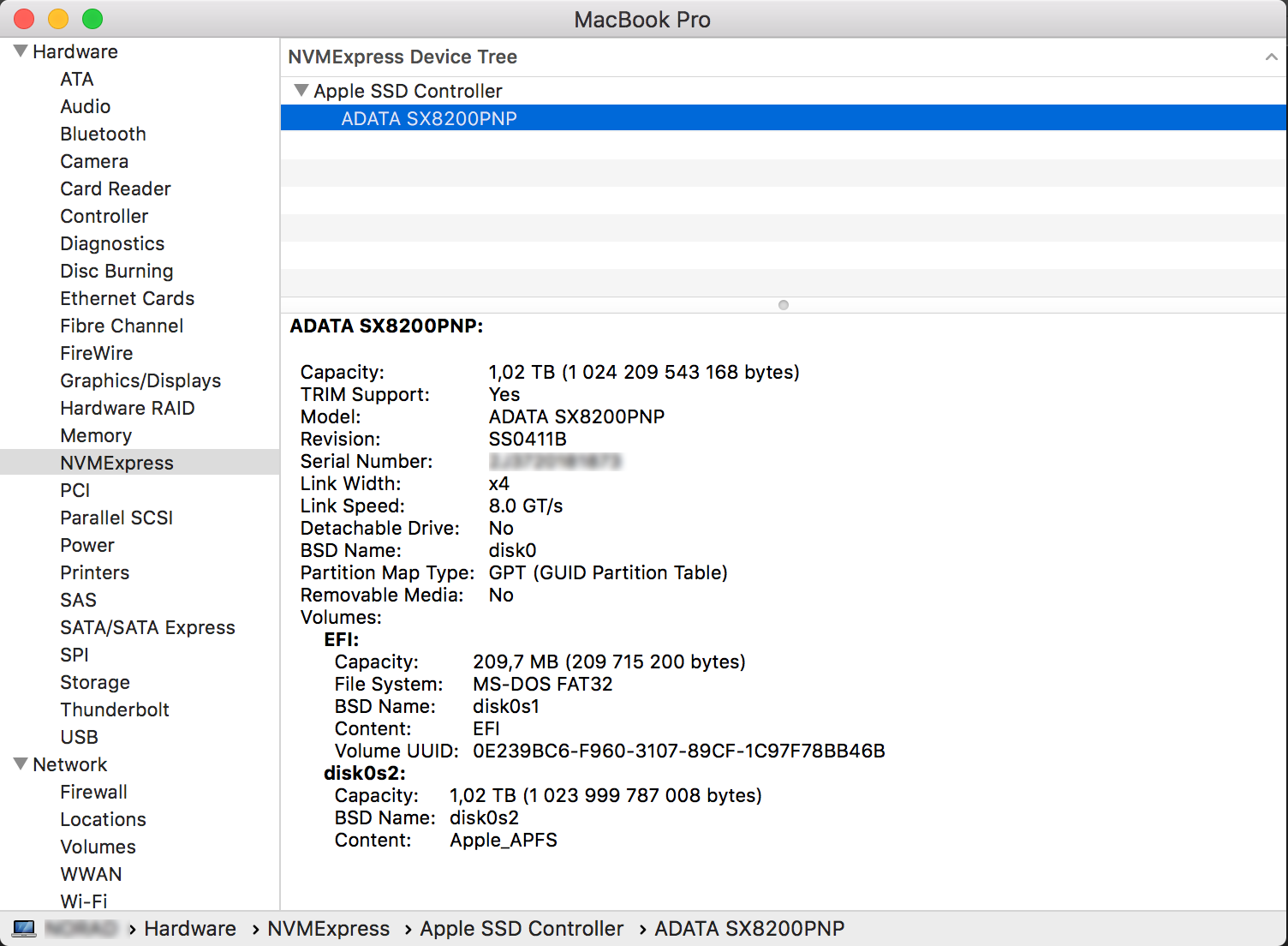

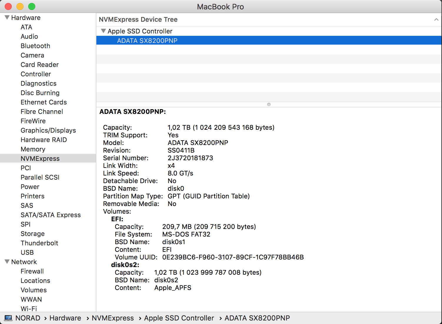

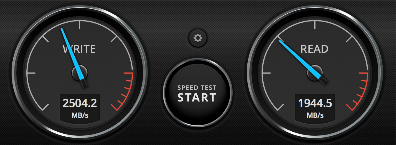

Here are the ADATA drive informations:

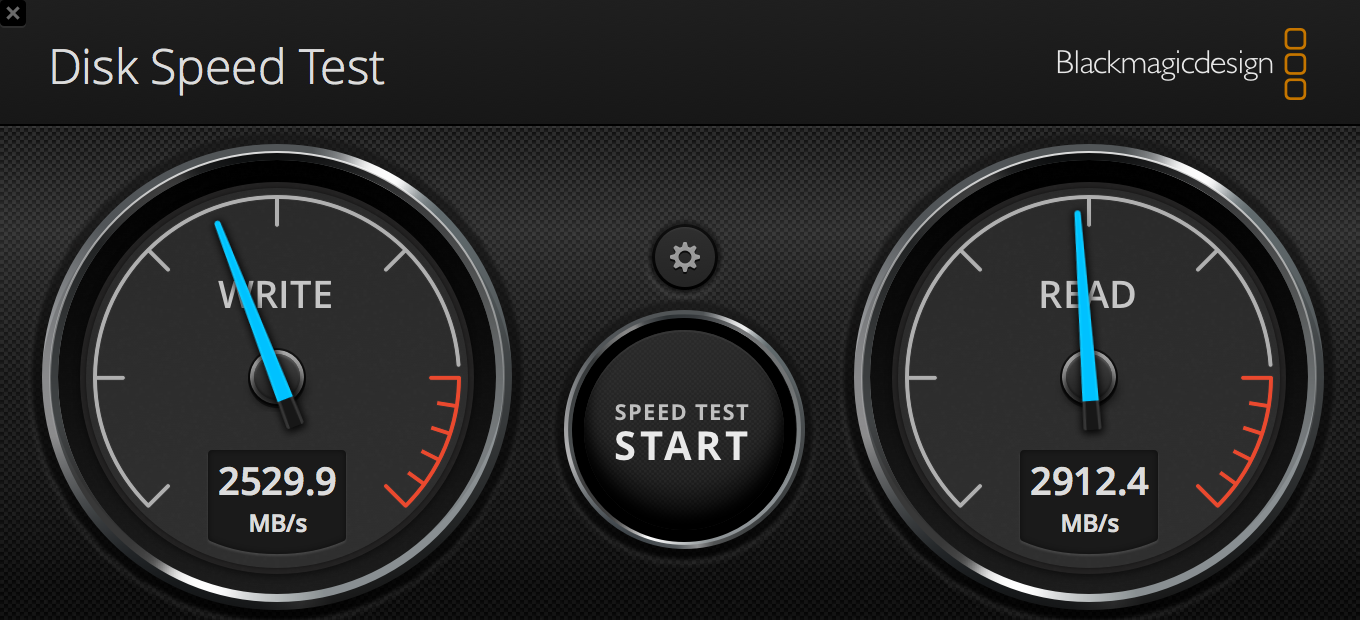

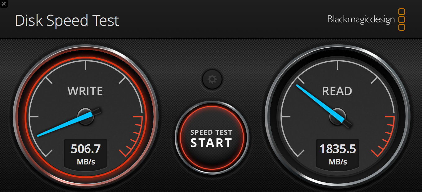

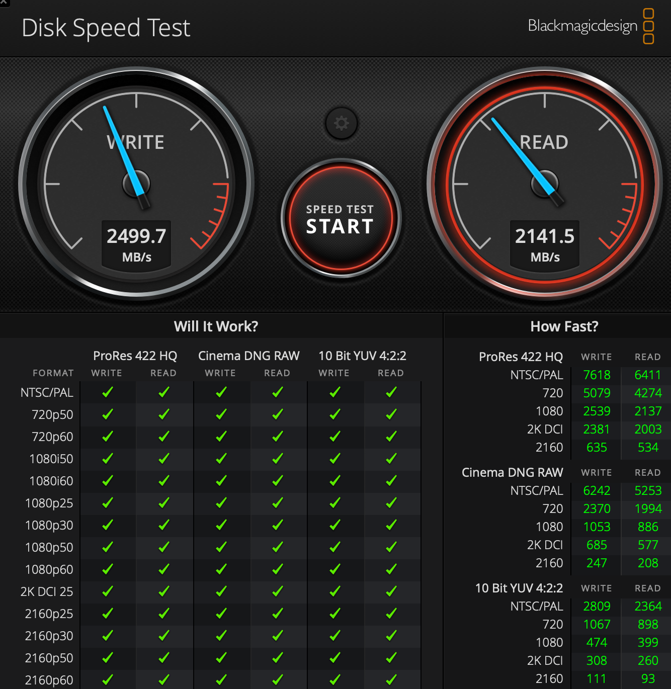

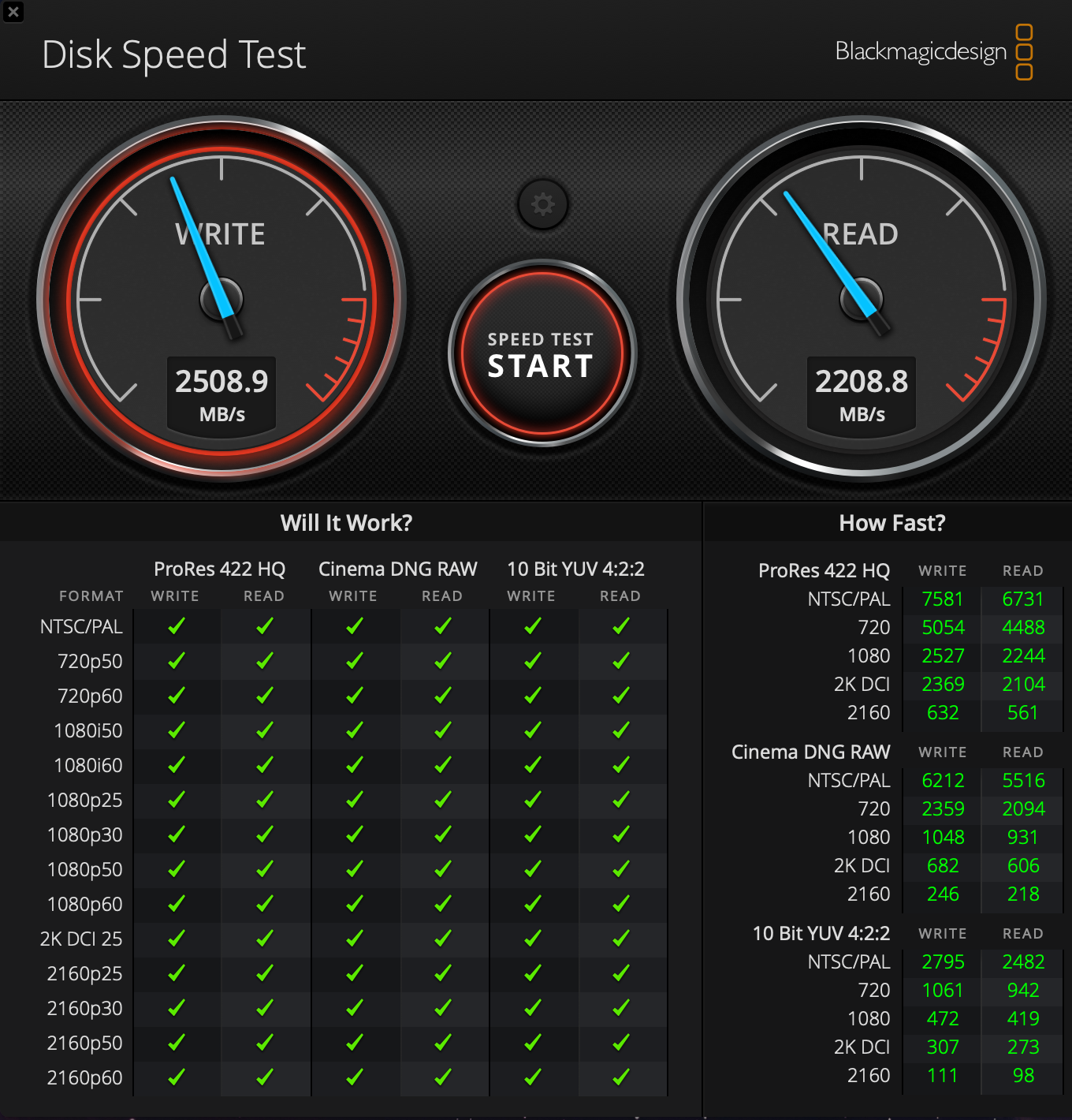

The Write & Read performance are stunning compared to the original one. The original SSD test show about 506 MB/s Write & 1835 MB/s Read, while the new ADATA SX8200 Pro show 2529 MB/s Write & 2912 MB/s Read
This is the Disk Speed Test of the Original Apple SSD (actually it's a Samsung)
This is the Disk Speed Test of the ADATA SX8200 Pro
No doubt, this is a huge improvement, I love it !

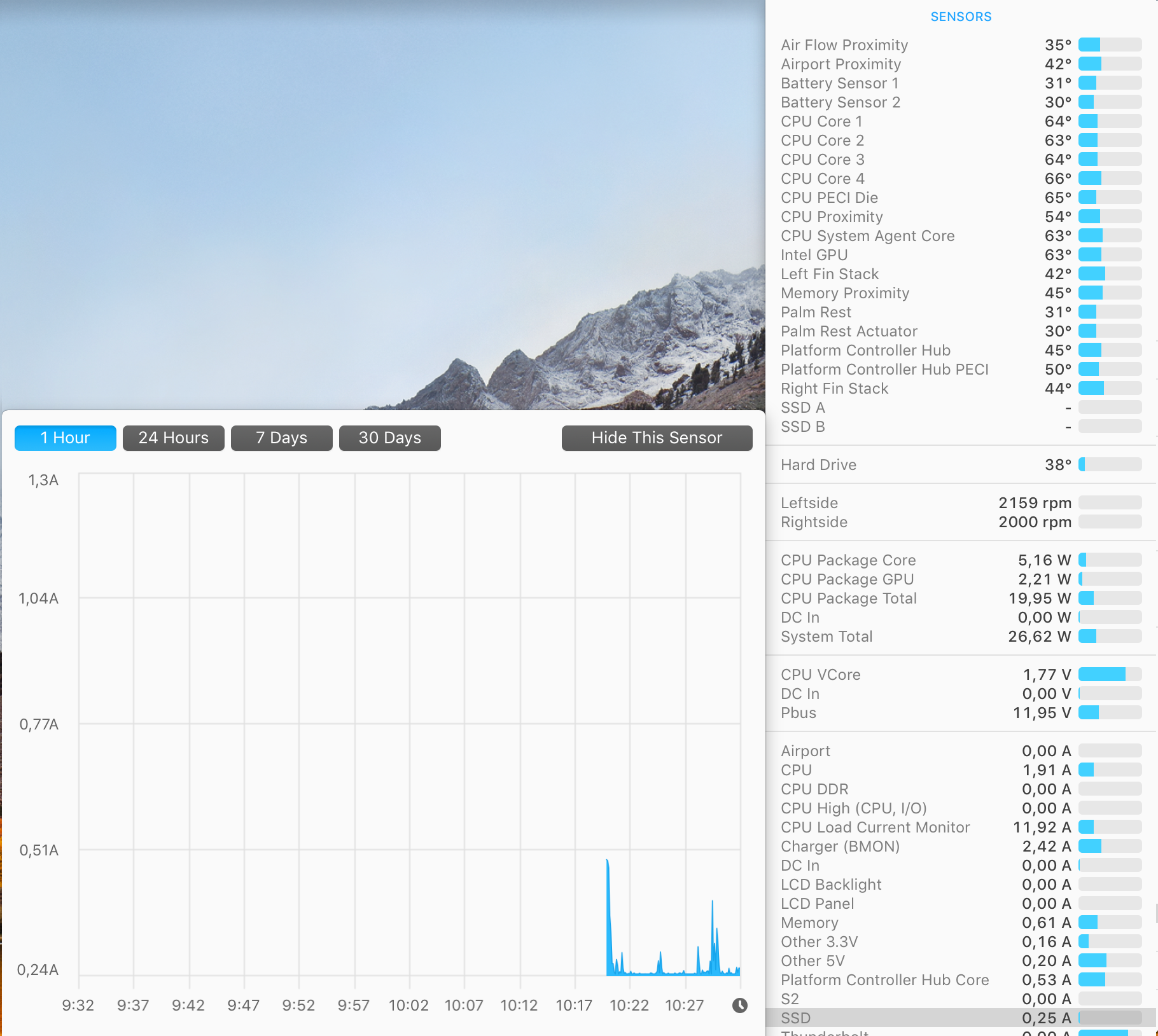

There may however be a small (or big, depends on your usage / needs) downside and that's battery consumption... I am not sure yet how much this is going to impact the battery draining, but here a some facts:

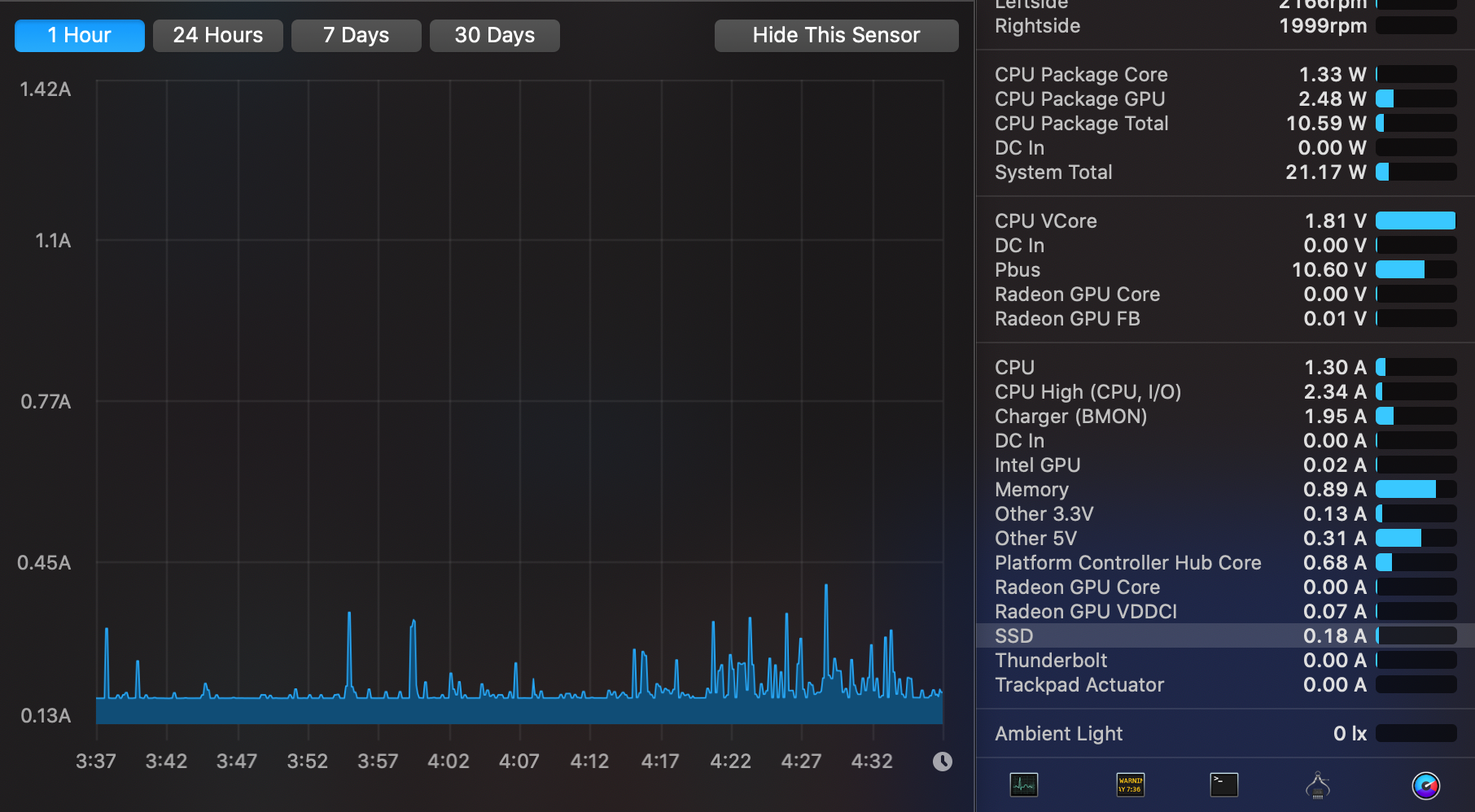

Here is the idle consumption of the Original Apple SSD (Samsung branded in my case)
Here is the idle consumption of the ADATA SX8200 Pro
So the original SSD idles at about 0.04A while the ADATA SX8200 Pro idles at 0.25A

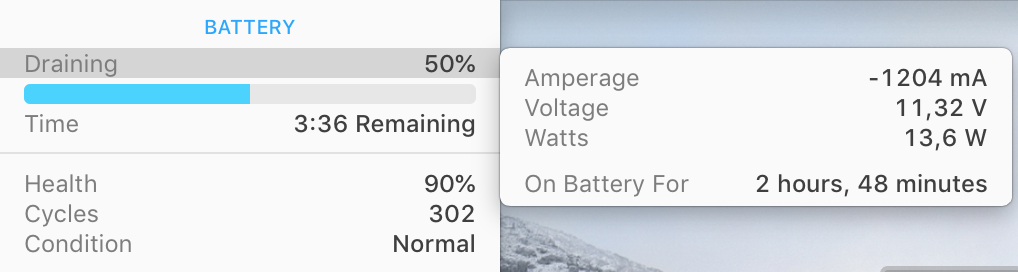

This is a huge difference and I don't know yet how much this is going to impact on the battery draining / battery overall time usage. I need to run more tests but this could give you an idea:
This is almost in idles condition, screen on, no screen saver, Wifi is on, Google Chrome running, and I almost only write this feedback, made a few screenshot & a bit of Photoshop.
In my case, the battery usage is not really a big deal / issue because I mainly use my station at work / home, mostly plugged, and I have another Macbook Pro (Retina 13 inch mid-2015) that I use when I am travelling because of the size, and the battery autonomy that is much better.

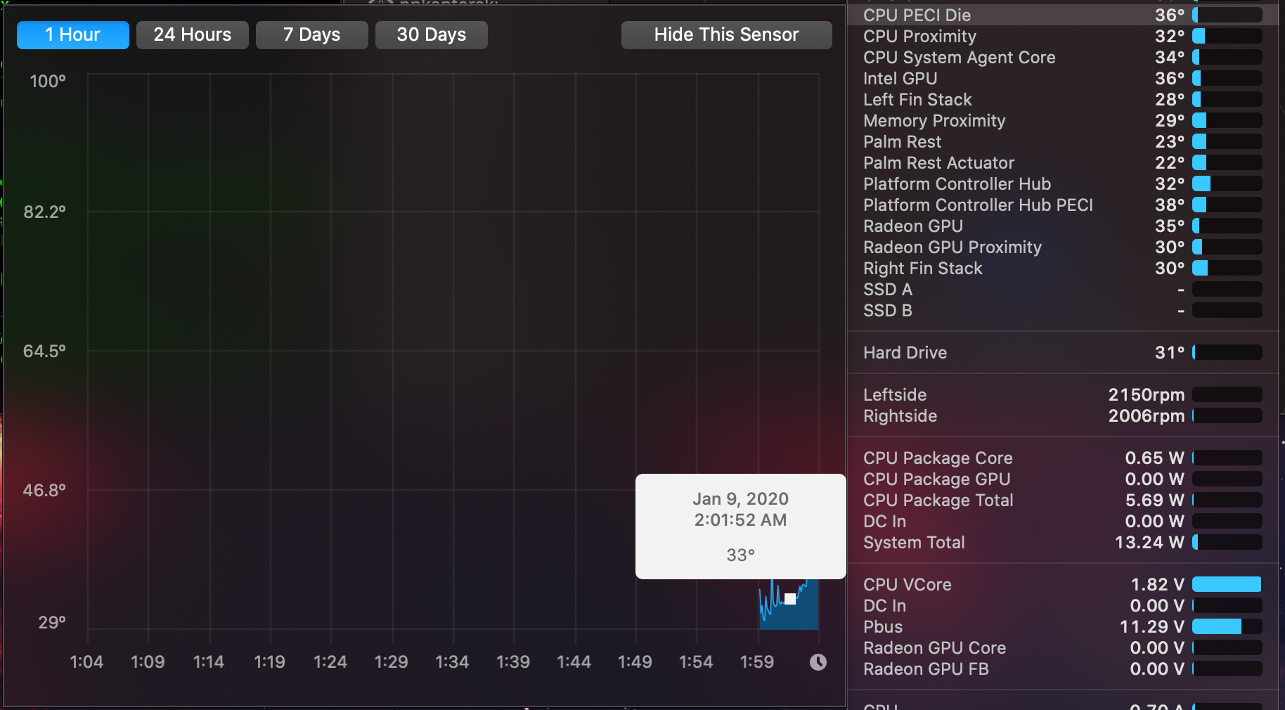

The SSD heating if you check the stats I provided are the same, 38°C. (FYI I added on the ADATA SSD the heat sink it came with. I tried without, and it look like it's better with it, I think I was around 42°C without)

So I just installed the Sabrent 1TB SSD into my 2015 MacBook Pro 15" and so far it works well. Everything transferred over with no issues so far. But read/write speeds seem to vary. See results below. These are all with the new drive. Sabrent claims that this drive will get up to 3400/3000 read/write. Is there something I am missing? Also how do I enable TRIM? Is it enabled automatically? I'm on High Sierra.
