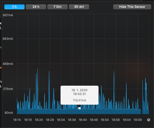

Hi,
This is my power draw, while some basic usage - browsing. Basically it does not get lower then 119 mA. It look like NvmeFix does not work also for me.
I've got MBPro 15 Mid 2015 and Sabrent Rocket 512GB.

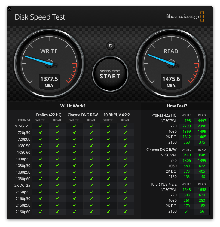

Hello everyone, I upgraded my computers -macbook pro mid 2015 15” from 512gb to 1tb Samsung pro970. I bought the sintech adapter (the long one) And installed it into my computer, i attached my new ssd to the adapter and the adapter to the macbook pro. I found that i dont get the best speed, and it actually really slow for it, i had tried to play with the adapter and the ssd and move it to the sided on the logicboard, i found its helping, when I did that I got speed up to 2580 write & 2250 read, but only for a short time, and than it goes back to very slow such as 1380 write & 1480 read. The reason i kept play with it is because i saw different of the speeds, but after i turn off my computer and turn back on the speed getting down again. I want to share with you the picture of my disk utility and what i did when I first installed the macos. I got to this because i think this is the reason that my ssd is too slow for an nvme ssd.
please, help me understand and guid me, what should i do the make the speed highest as possible?
And what is the reason/what i did wrong in the installation that my mac is super slow.?

It is difficult to understand your post.
From what I can tell - you say that running the speed test starts out fine then the speed drops? This has been reported previously in the thread and simply has to do with the speed test cache.
Can't comprehend if you think the computer is slow outside of the speed test as well or it's solely based on the test?

hello, I can tell that the computer is slow as well. the highest speed I got was 2580 write, 2300 read.
I felt the difference between the speeds now and then. now I dropped down around: 1400 1300 read write.
I don't understand where is this problem came from.
according to nvme ssd it must be higher speed and Im very disappointed that im not getting the best of it, or at list the best I can get from my computer and the new nvme ssd.
im sure that something is wrong in the settings of my computer, im sure something don't let my ssd get the highest performance.
please help me.

you posted screenshots where the ssd was 85% full - maybe that has something to do with the slowdown.
i'm surprised that a 1400/1300 rw speed is in any way noticeable as slow
the answer is probably to stop running read write tests.

Do you have FileVault on? I think those of us who got 2GB/s speeds don't have FileVault on. (At least I didn't, Sabrent Rocket 1 TB on rMBP 2015 15")

Can You try to use lspci to check the ASPM Value on the SSD?. Refer to my post no. 5261, 5282, pg 211-212. I switched my production machine to Sabrent and the Samsung SSD is now an external and is in use so I can't check right now.

If NVMeFix reports that APST is turned on, then APST is almost certainly on.
I suspect iStat is reporting ISDC, PSDC SMC keys, but I don't know what they exactly indicate and how they are physically measured. Rather than looking at this graph, you should compare battery life with and without the kext.
FWIW on Windows StorNVMe reports APST enable success, and I am getting approximately the same ISDC and PSDC values as on Mac. However, for my typical use case I get 30-60 min longer battery life with APST on.
