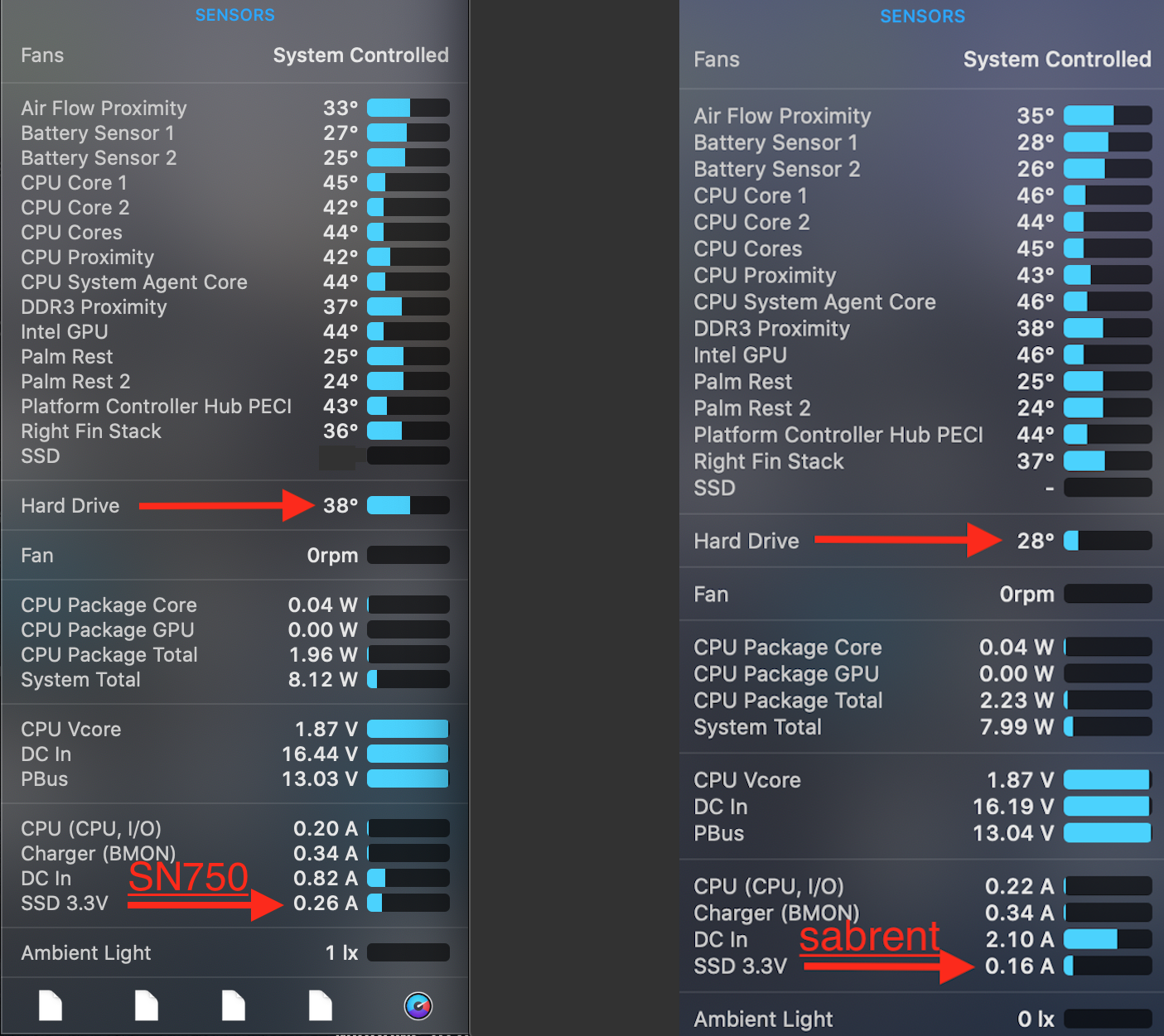

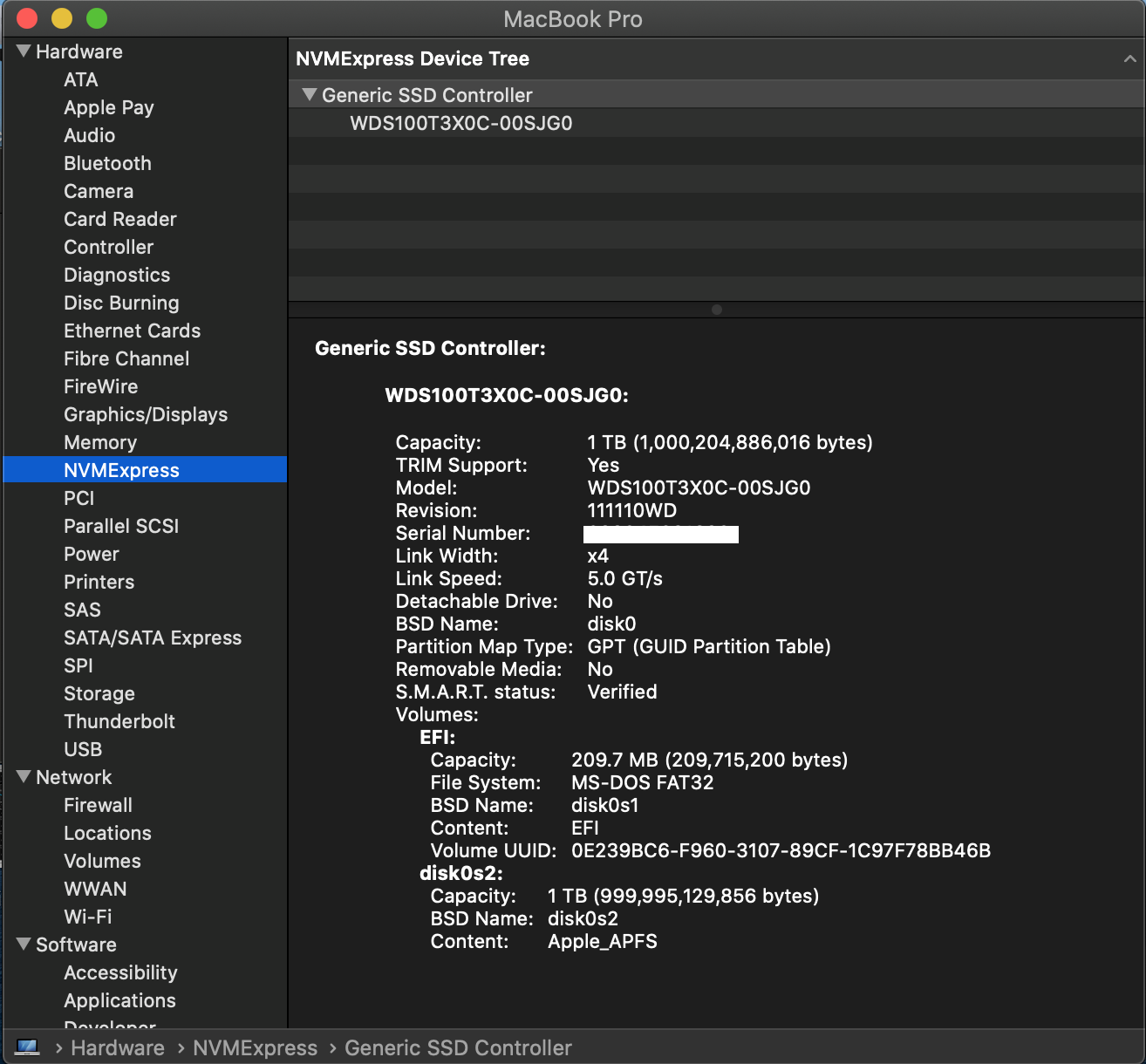

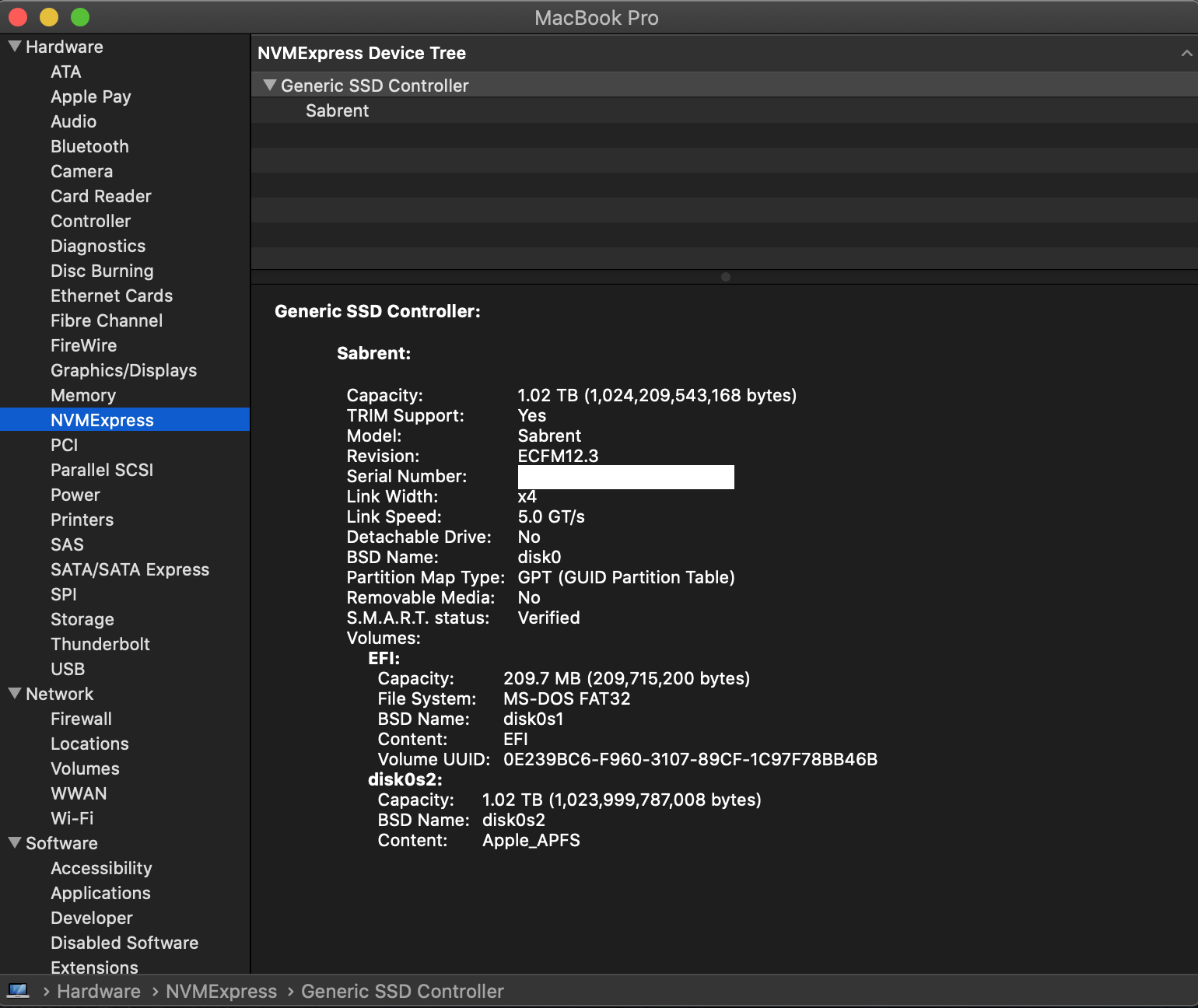

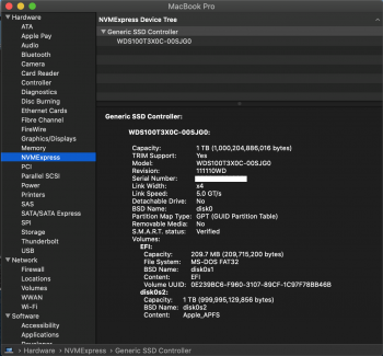

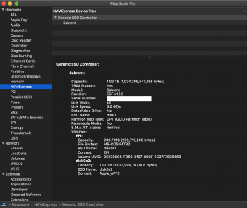

i don't have any sleep/hibernation issues with my early 2015 13" MBP WD SN750/sintech small adapter combination, its just runs a little hotter than Sabrent rocket 1TB.
Reactions: Fabmac

Quite a lot of diferente sad not seen it before (sabrenet drives are cheaper than the wd)

You are correct, the late 2013 Retina does not support m.2 sata drives.
An original Apple SSD or m.2 AHCI drive will show up under system report as SATA Express.

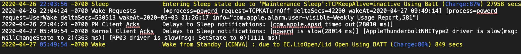

here's my 2015 13” MBP sleep/hibernation results overnight just 1% battery loss that's almost 8 hrs deep sleep.

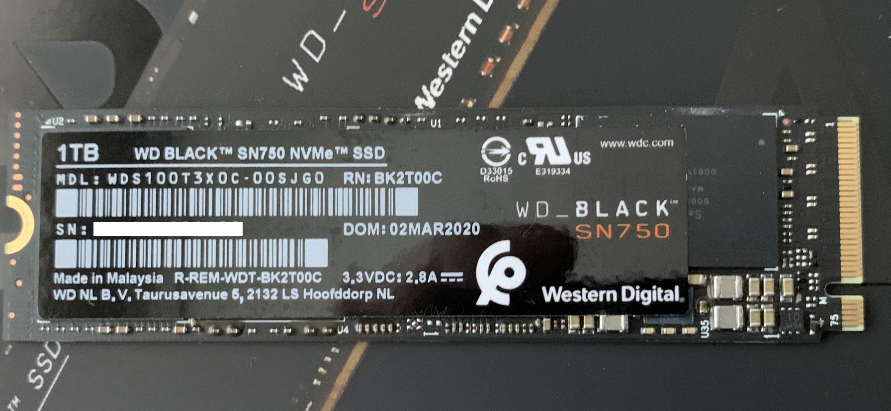

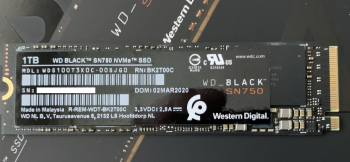

WD SN750 working fine so far. 45C peak temperature (on heavy load working in Photoshop)
they are fine to 70c so it's ok...
