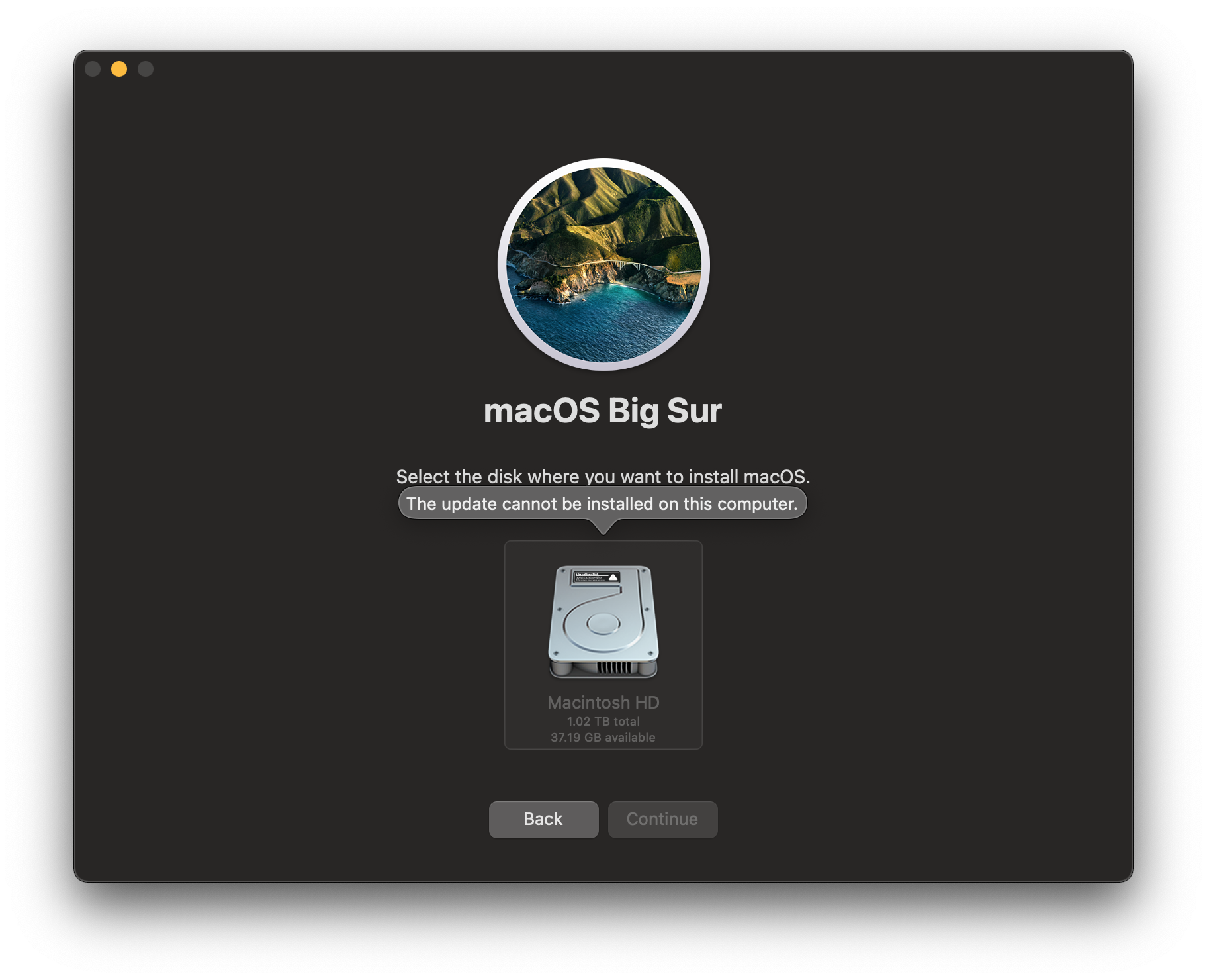

Well, I meant that blocking the macOS Big Sur upgrade in the respin blocks the entire macOS installation (see screenshot below) and wouldn't install anything. And as you know, the system firmware upgrade is typically initiated as part of the macOS installation.
Here is the link to the support documented that I referred to: https://support.apple.com/en-us/HT211242. This sounded like something during the installation other than a firmware upgrade 'bricked' the MacBooks. Perhaps the adjustment of the disk layout? https://eclecticlight.co/2020/09/16/boot-volume-layout/. Anyway, just speculation on my part.
