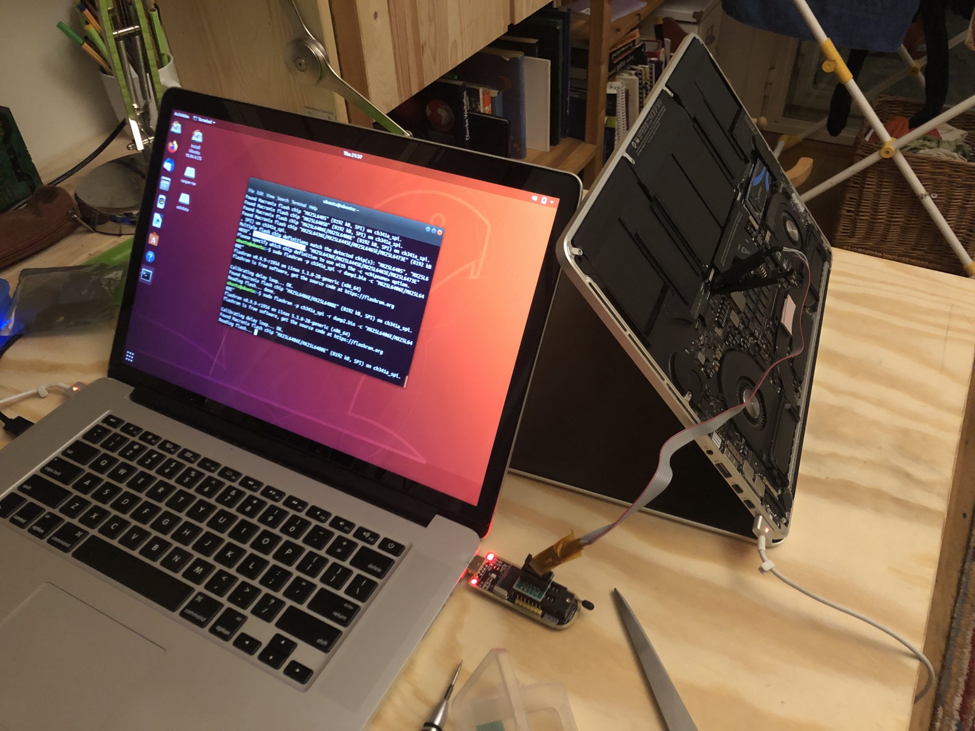

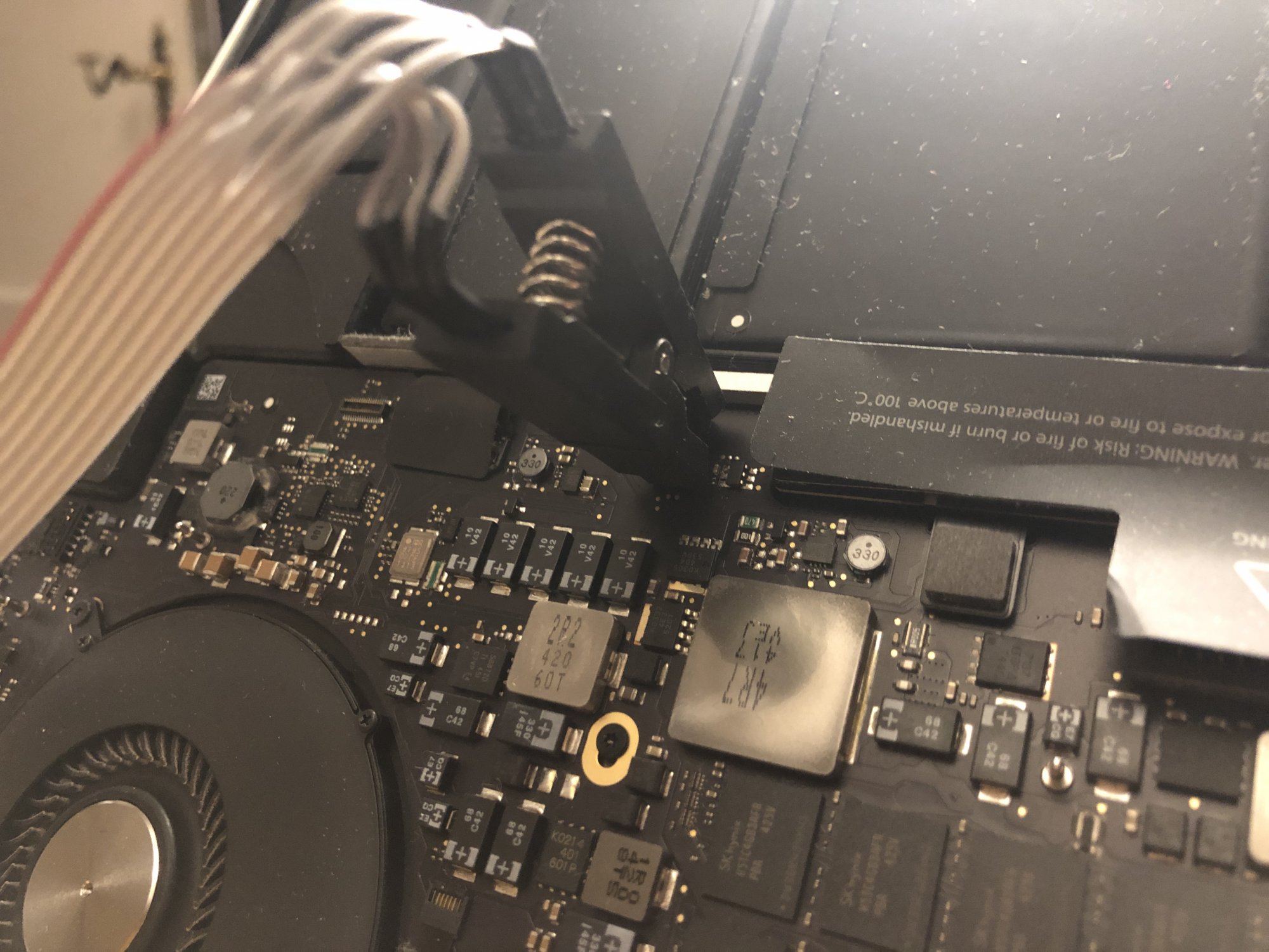

Hi, could you please explain in detail how you attached the SOIC Clip to the EFI chip and maybe how the chip exactly looks like. Any other advices to avoid risks and screwing up my motherboard are very welcome. I have a Macbook Pro Retina 13" Late 2013. I find it ridiculous to pay more than 50 bucks for the J6100 adapter so I hope to get the update done only with a SOIC Clip.
I found this SOIC8 SOP8 Clip on Amazon Germany:
Do you think this will do it with my MacBook? One of the reviewer says that he made it work but he didn't say if he used this clip only or in combination with a J6100 adapter.
Honestly, I am little afraid to screw things up on my motherboard when playing around with the clip and clamping it on a chip.
Why don't you apply the "patch" for the BootRom as described by @otosan in post 7760 instead?
The EEPROM flashing process is obsolete (and more dangerous) now that you can use Big Sur's BootRom.
I know from personal experience that the SOIC-8 clip won’t work on a 13” Pro. The issue is that the EEPROM chip has a different package that does not expose the leads very easily. If you desolder the chip, it can go in an SOIC-8 clip since the pin spacing is the same, but I don’t recommend that.
Here is my post from when I patched my bootrom; I wound up soldering wires directly to the chip on the board.
However, I agree that the best route forward is just applying the Big Sur firmware update. No soldering required!
