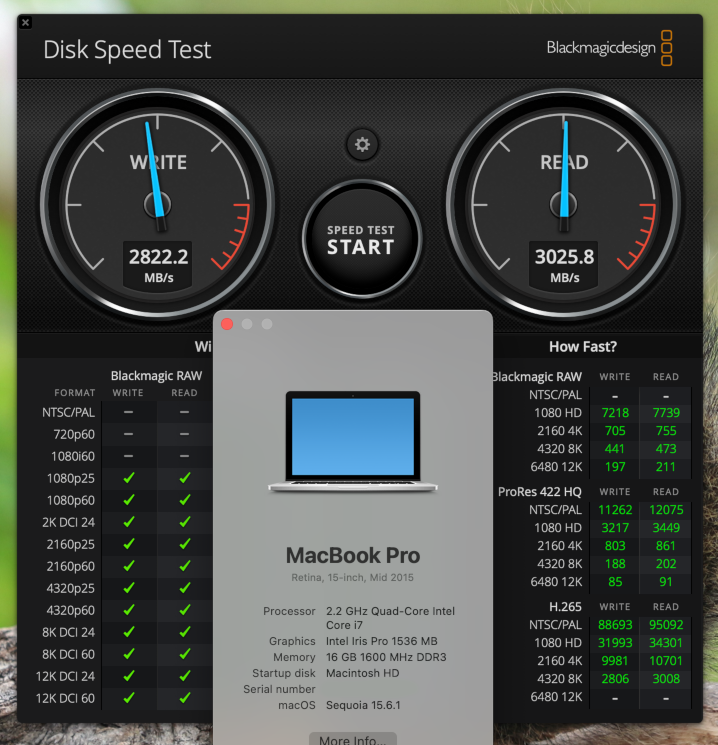

I upgraded my 2014 Macbook Pro a few months ago with a 2TB SK hynix P41. I had absolutely no problems and it's fast: 2800 write, 3000 read.
(I expected at those speeds to have decent bootup time in Sequoia, but it's still about 4 times slower than booting up Mavericks - with around 700 read/write!)
Edit: it's actually a 2015 Macbook Pro. (who knew? 😉)

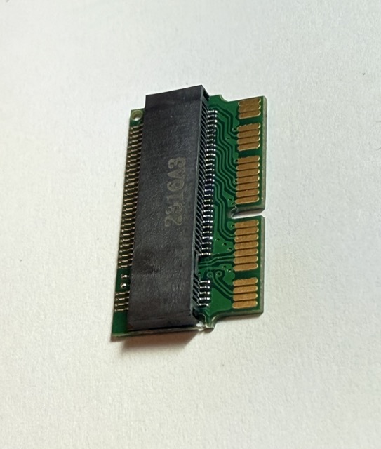

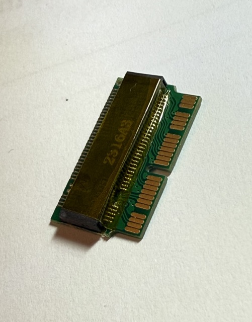

You need make sure the adapter pins are covered with a Kapton tape to avoid the pins shorting on the metal connector onto logic board. See pics below.
Before:
After:

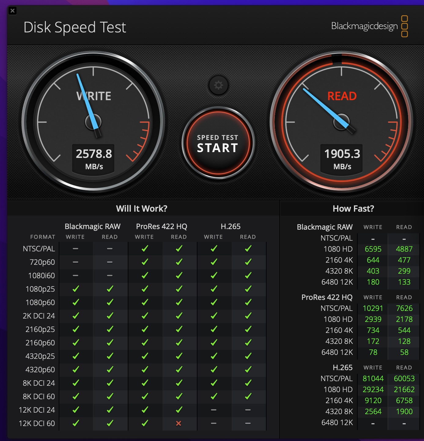

I have EVO Plus 500GB with 2B2QEXM7 installed on my 13" rMBP12,1 and works well:
It runs a bit warm when working hard.
Speeds before (Apple 128GB SSD):
Speeds after (EVO Plus):

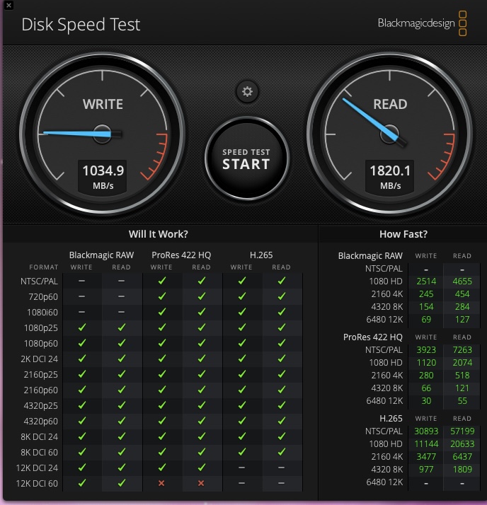

Before and after installation of Samsung 970 evo plus 2tb with Sintech adapter (long) to to a macbook pro 2015 15”. Fw on the SSD: 4B2QEXM7, Band width: 4x)
Any advice to get more speed? do you have the same speed with the same setup?

Well, I'll be a son of a....
Somewhere along the line, I seem to have gone mental - and mistakenly started thinking that I got a used mid-2014 Macbook Pro when actually I had a mid-2015. (must have gotten confused with the model number 11.4 - my previous new 2013 Macbook Pro being model number 11.3)
Here's the screenshot anyway:
How did you that? I have a Samsung 970 evo plus (fw:4B2QEXM7, band width: 4x) with Sintech adapter and max writing speed is 2.5 gbps and reading 2 gbps.
