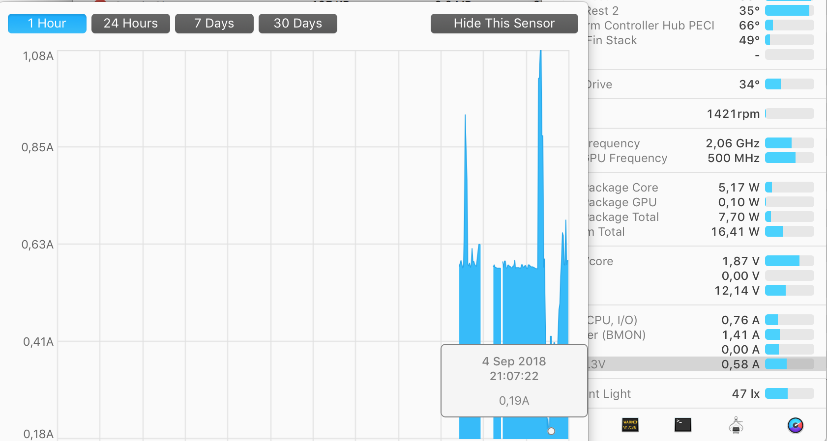

The SX8200 arrived. Testing it right now. I left the pmset hibernation in 25 for the time being. I can tentatively confirm that the power usage idling is circa 0.19. Here is a screenshot. I will report tomorrow about how long the battery lasts.
Ok, after a day of testing , battery life went down from 5 hours with the apple stock ssd to 4 hours with the sx8200 (250gb) , there is also more heat (I understand this should not be an issue) probably because all the Mac is aluminium. All in all , it is a trade of 1 hour battery life for more storage at a reasonable price. I think I will keep it as this.

So the SX8200 came in yesterday. The installation etc. worked normally, except the SX8200 doesn't format with 4K sectors, unlike the WD. I'm not sure if this is going to be a problem in the future.
As reported here, the idle current draw is 0.19A, about half of the WD Black G2. On rMBP 13" Early 2015, the read speed is 1500 MB/s and write speed is about 1100 MB/s. I must note that sustained write is actually much faster on the SX8200 as compared to WD G2, which starts out at 1200-1300 MB/s and dies down to 600 MB/s within 10 seconds. The temperatures are also lower with the SX8200.
The battery issue is still open though. In one three hour sleep, the MBP drained 16% (!) of battery. An overnight sleep of 7 hours only resulted in 4% battery drain. After some digging, I think the cause of battery drain is because Mac keeps waking up every 10-15 minutes to perform some network operation. This is a reported issue on line, and could be fixed with setting tcpkeepalive to 0. For some reason, Mac stopped waking up after 1 hour of sleep when left overnight, and thus the low battery drain.
