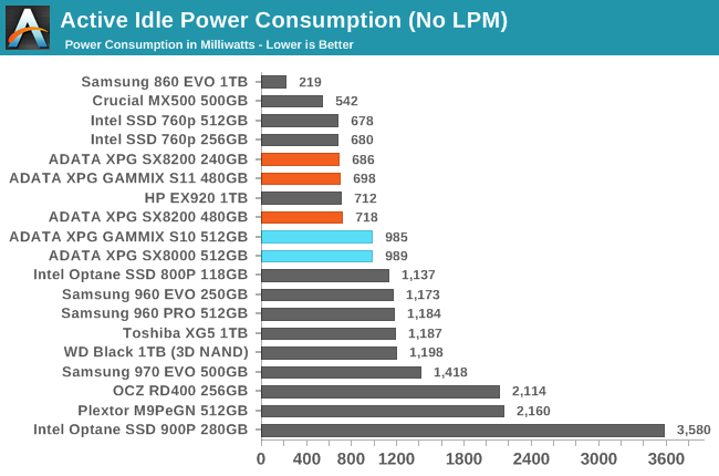

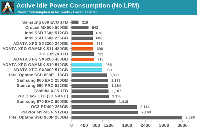

With idle usage, I feel that the battery drain is 50-70% more as compared to stock. That is probably expected given that WD draws 0.35A while the stock draws around 0.15A (I have not seen the stock draw personally but others have reported this). I can live with that.
The bigger issue for me is power draw during sleep. The stock SSD was very economical with that, whereas WD draws 3-4% battery per hour. Is it the case that these aftermarket SSDs are not being put in low power state during sleep? The workaround is to set hibernatemode to 25, which is not very noticeable on wake up.
Still might be worth going for SX8200 or Intel 760p. I bet the idle usage would be lower on them as well. I don't need very high write speeds and I don't usually read/write large files.
Reactions: foliage
Yes I believe so; that Mac OS hasn’t the necessary code to enable low power states for third party NVME drives, which is definitely a source of frustration. I wonder if someone more knowledgeble than me would be able to find a workaround for this. Anandtech’s schematic (attached) shows ‘active idle power consumption’ which may be the true power draw in the setting of Mac OS.
And yes SX8200 and Intel 760p appear to be great options re performance : power usage : price, if 970 EVO / WD Black G2 are too power hungry for one’s usage.
