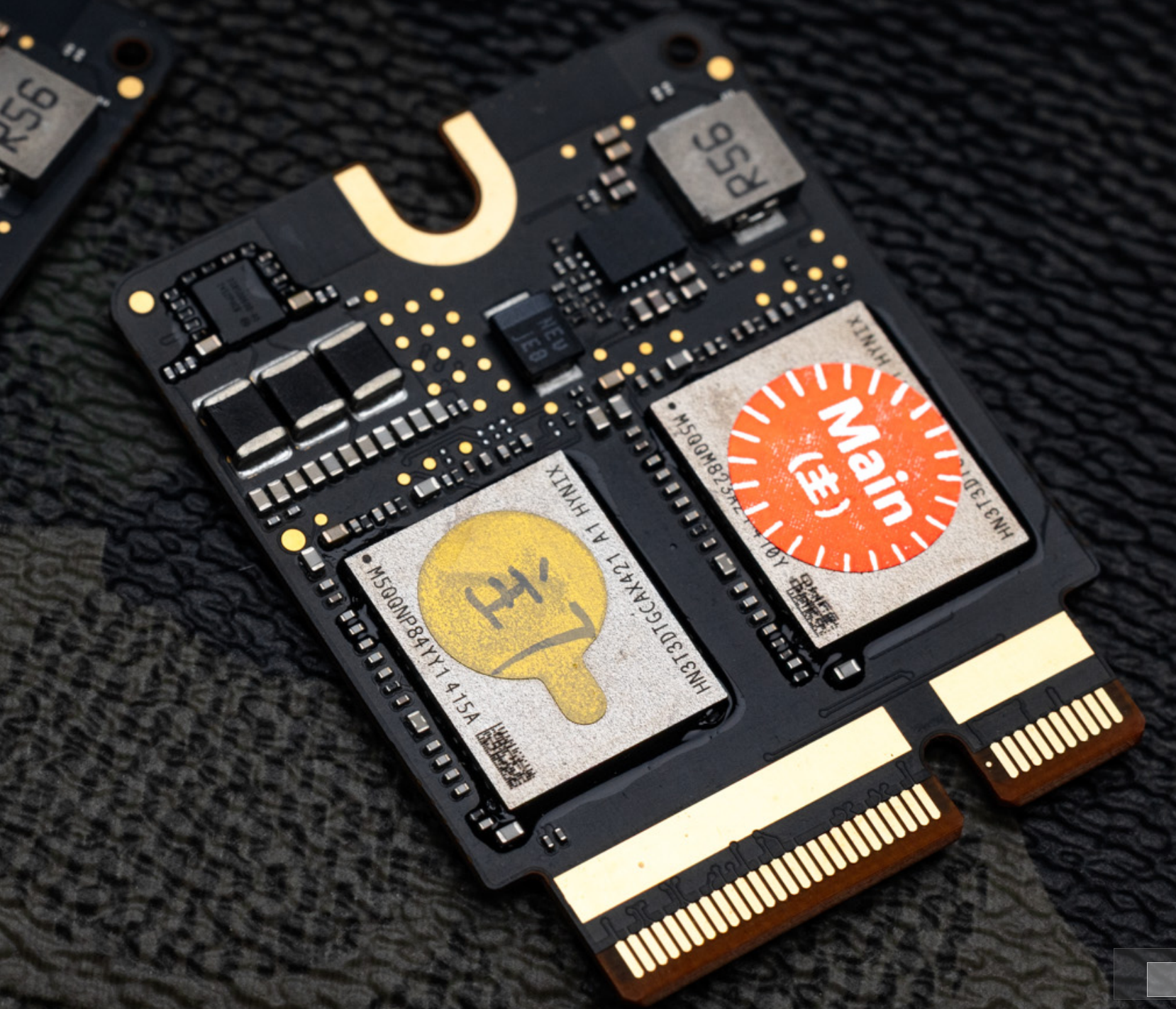

Just wondering. Is the Aliexpress store the same as Polysoft, or did the Chinese company that created the first batch now sell it? Did he get ripped off by the copy-cats🤔?
I need to know.
I need to know.

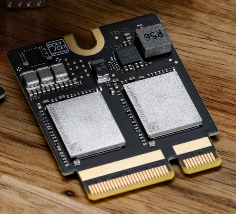

I don't believe they are the same operation. The top is the Ali one and the bottom is the Poly one.
The work on the Polysoft drive is a lot more meticulous. There appear to be slight differences on the PCB/surface components as well.
The black stickers covering the location where the Polysoft markings are on the Ali drive are interesting, but they could have ordered blank PCB or had someone reverse engineer them. Pure guess on that one as I don't have the Ali one anymore to see what's under there.

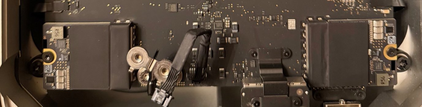

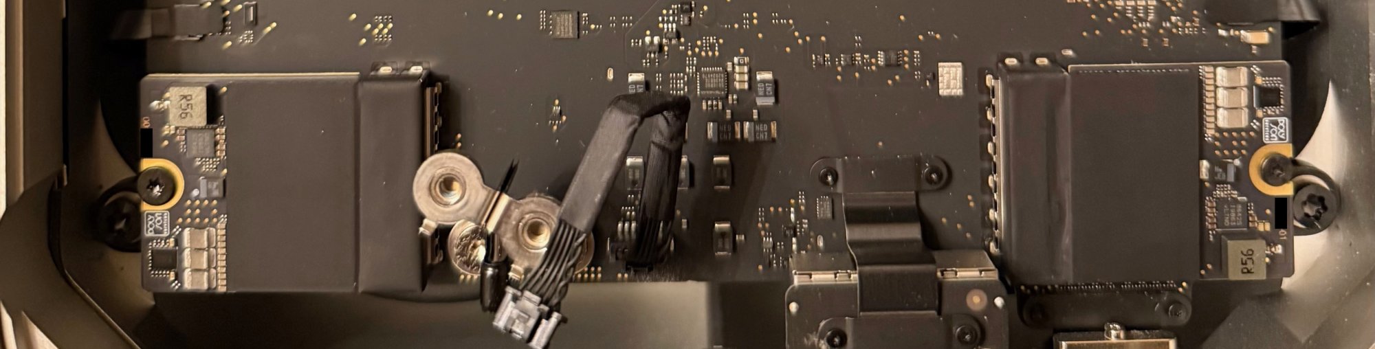

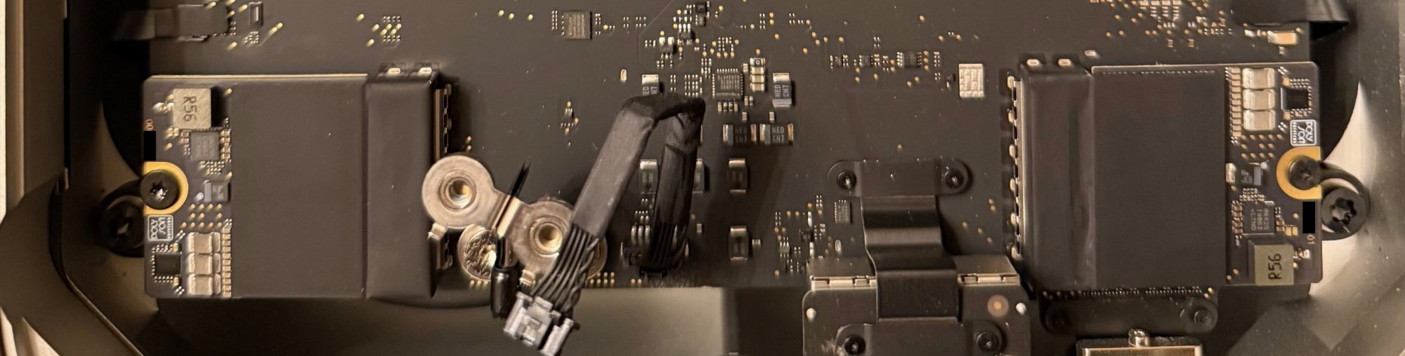

However… I have no manual or documentation.
Which SSD card goes where?
I have no idea which one is the main board, which is secondary, etc.
Any help or photo reference would be greatly appreciated! 🙏
The seller on Ali will have the SSD'd marked. The slot that is currently populated on the M4 will be the Main or 00 slot and 01 will go into the empty slot.
Reactions: Molecular1958

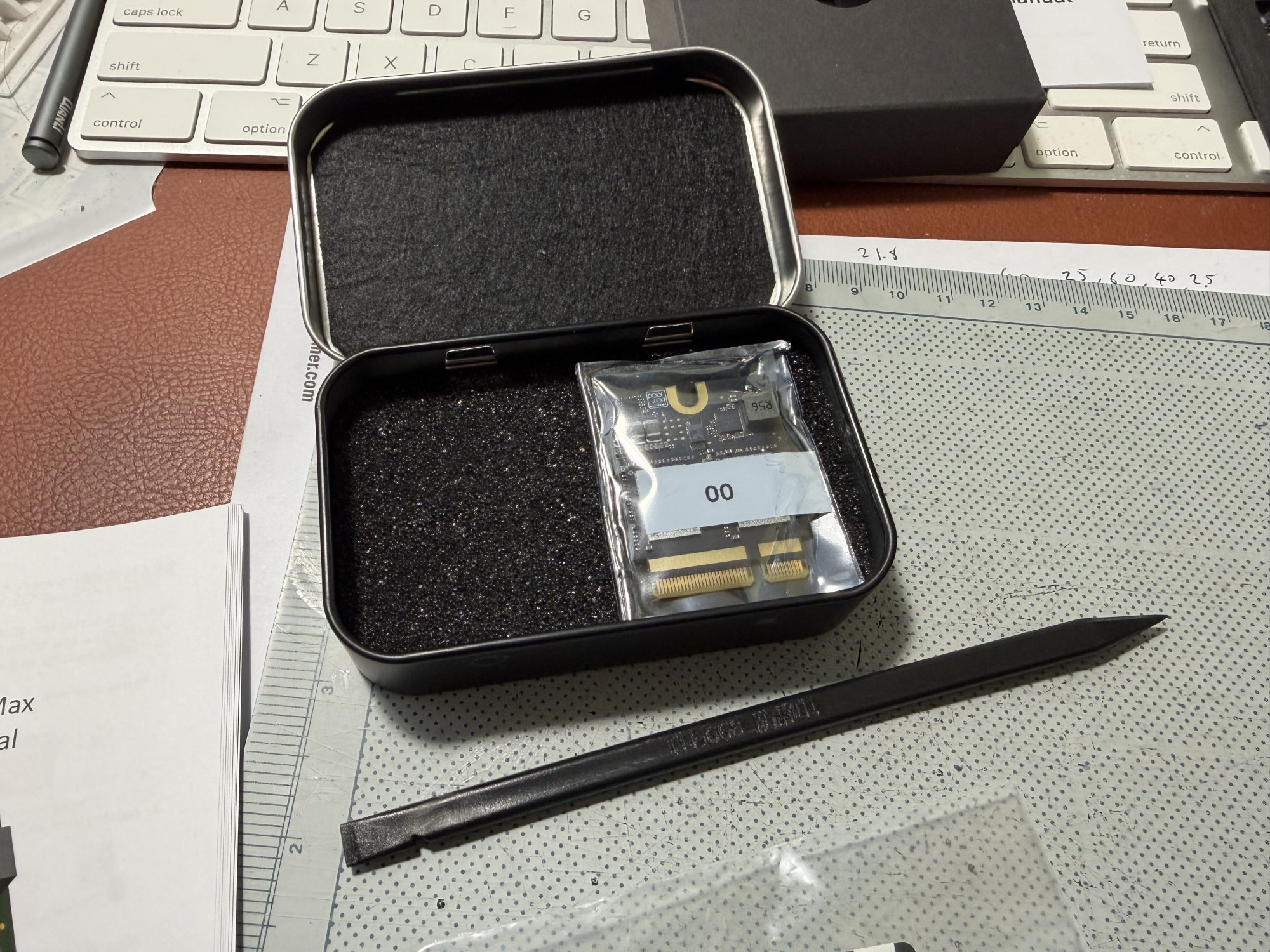

I received an early Christmas present today, the SSD kit from Polysoft for my M4 Max Studio finally arrived 6 months after I ordered it, ‘only’ 4 months overdue. The kit contained the SSD modules, a black stick, SSD screw, and a iFixit Minnow screwdriver kit. A bag of chocolates was also included with a ‘Sorry for the delay’ message.
It has been a very long wait to get my order and I’m glad I’ve finally received it so I can get on with other things in my life. I hope that everyone still waiting will get their order soon.
Installation Experience
In general the experience was smooth, by following the instructions in the supplied printed manual. A few observations come to mind:
  • It is easier to remove the bottom cover ring using a ‘guitar-type’ plastic pick, rather than the black-stick: just insert the pick underneath the ring and slide it around to loosen the ring.
  • The bottom cover screws are very tight (2 N-m) and they need a lot of force to remove. Ideally you should use a wider driver that can supply more torque. I used another driver I had to do the job. The supplied iFixIt Minnow driver is a bit thin to apply the necessary torque.
  • The SSD module screw supplied is not the same as the original Apple one. The one supplied is a T6 3.8mm flat-head with a smaller head diameter than the original. The original is a T8. It would be better if Polysoft supplied a screw the same as the original. You can get originals from the Apple self-repair store https://selfservicerepair.com (part number 923-12514). At least the supplied screw is flat-headed, unlike the countersunk ones supplied with the AliExpress modules, so the module should not be damaged by tightening the screw.
  • I applied an SSD cover for the second module (part 923-12516), and replaced the bus bar cover (part 923-12481) as per Apple installation instructions.
  • I also used a digital torque wrench to ensure all screws were tightened as per Apple specifications.
  • I used an old Intel MacBook with Apple Configurator 2.16 (which updated itself to support the restore) to do the restore and update which worked without issues.

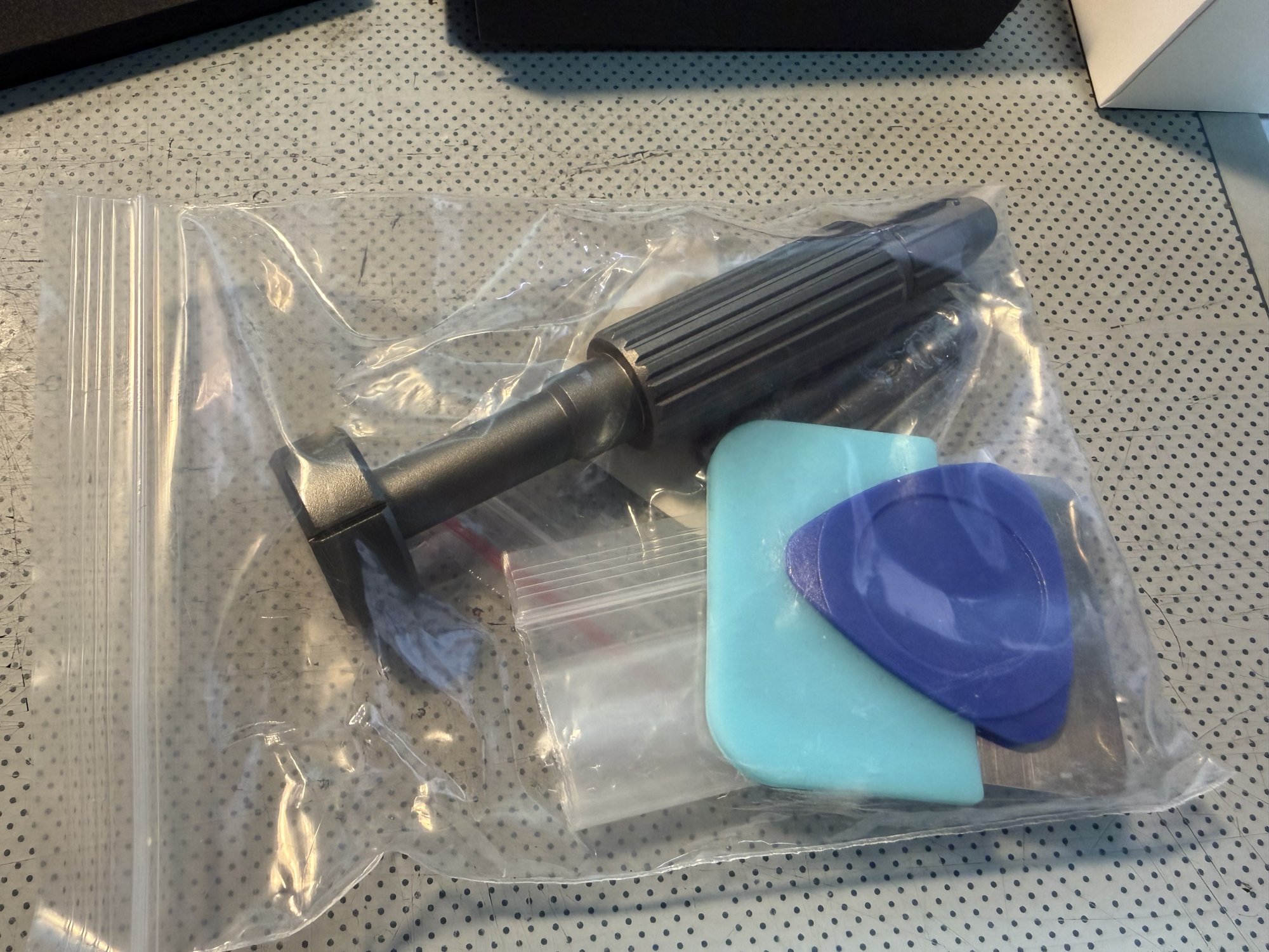

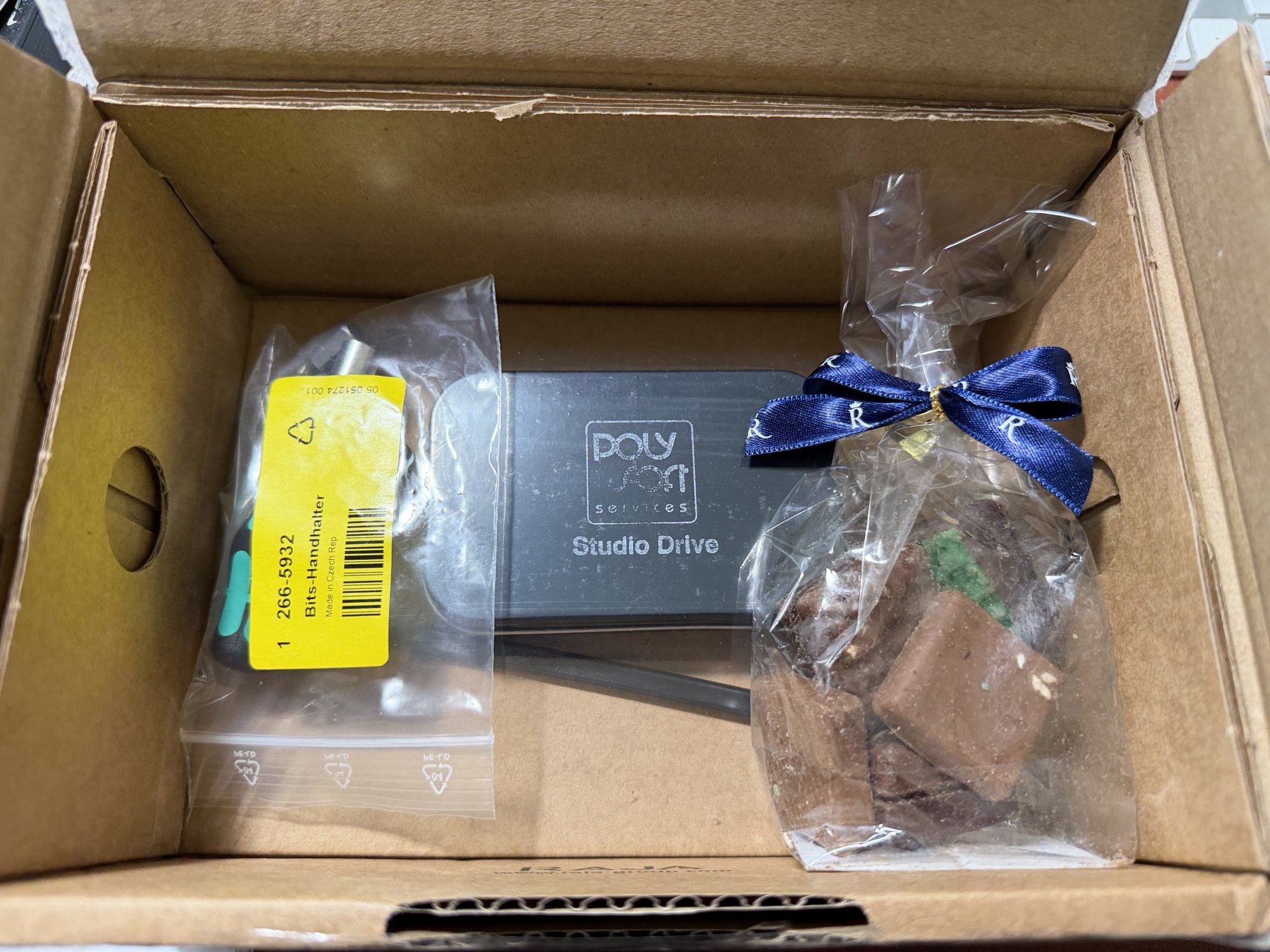

I would suggest Polysoft change the supplied install kit to a Wiha driver with the required T6, T8 & 10IP bits
Interestingly my Polysoft SSD came with a Wera diver with T6, T8, and T10 bits, so it seems the Minnow is not universal.
Aliexpress FANGYUAN SSD
The box brand was Lynxis, which looks like the brand other Ali stores sell. They come in a nice box but not in any anti-static bags like Polysoft. Tools are also included along with a thin metal pry tool and 'guitar pick.' Unfortunately the pick was too thick so I had to carefully use the metal tool to remove the black ring. No scratches if you're careful. The NAND themselves are labeled Hynix but don't have black underfill like @Den-Fi.
Installation was smooth but I used Polysoft's instructions as the Lynxis one wasn't as detailed. The bottom cover screws were indeed very tight so I ultimately used my own tools. Restore was also simple. Just connected the DFU MacStudio to another Mac and used the Finder to do the restore. Didn't need Apple Configurator 2.

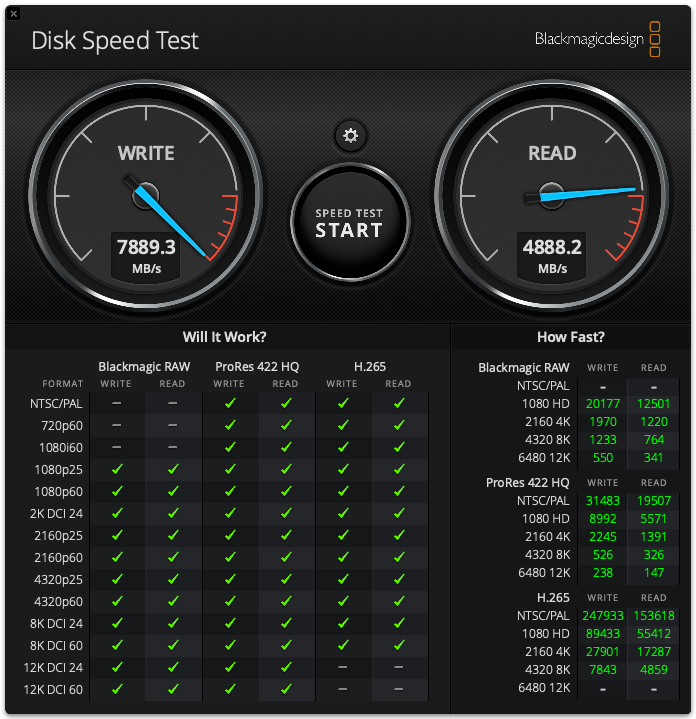

Performance was on par with what everyone else is getting. Amorphous disk mark summarised below. I bought the 512GB MacStudio so it's speeds are after the /
4GB Read (MB/s)4GB Write (MB/s)64GB Read (MB/s)64GB Write (MB/s)
SEQ1M QD87368/66628462/414369667003
SEQ1M QD14222/33827489/414319873971
RND4K QD641012/1241261/156584252
RND4K QD154/6239/393227
