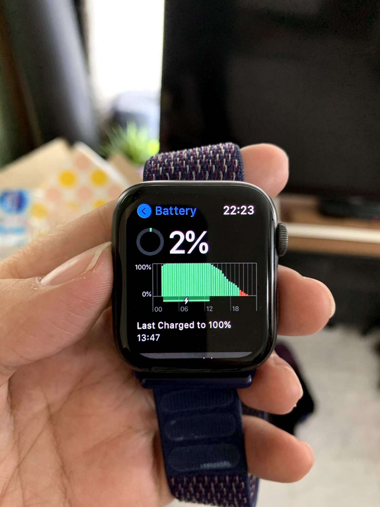

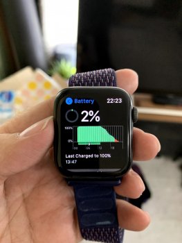

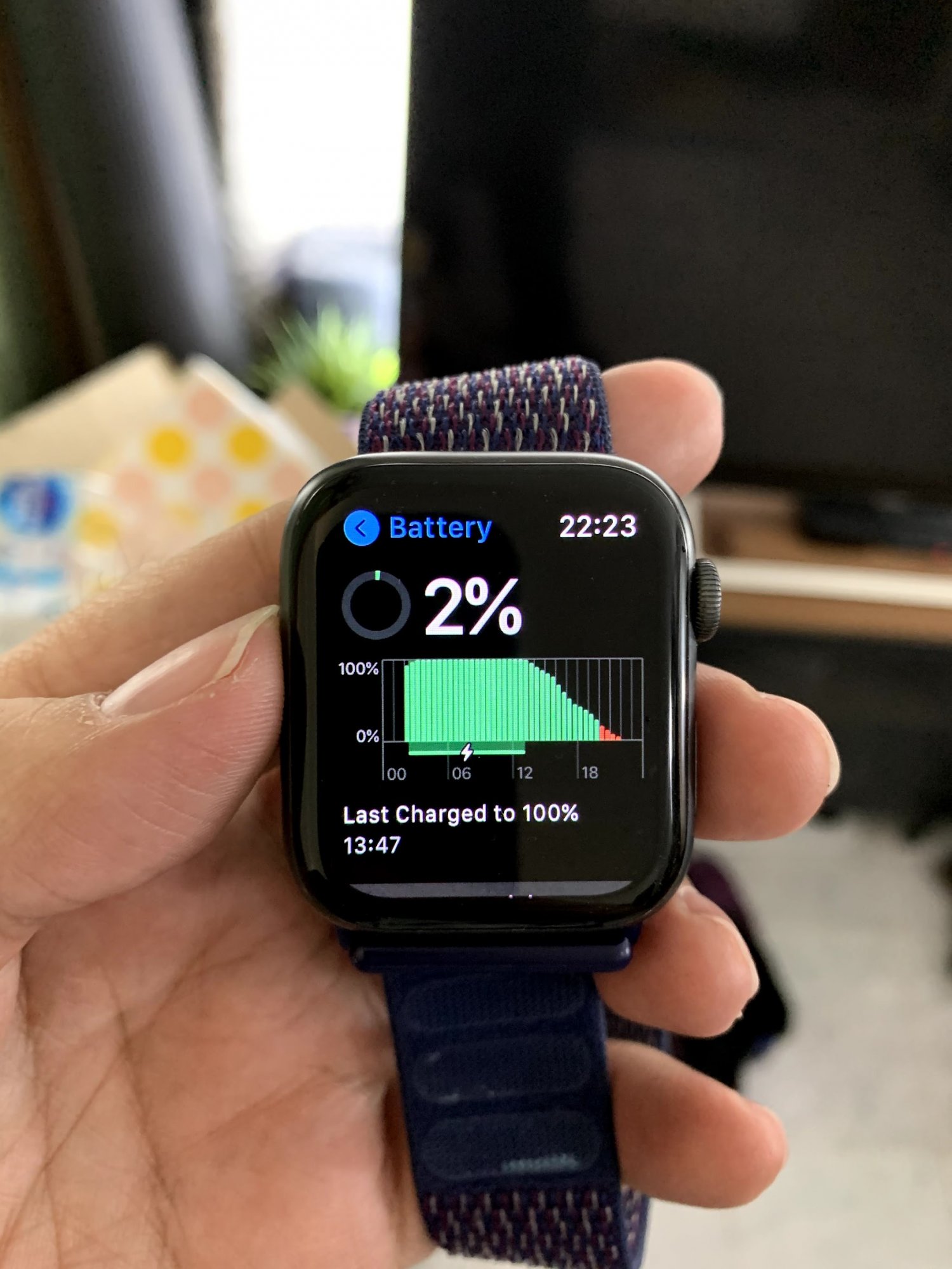

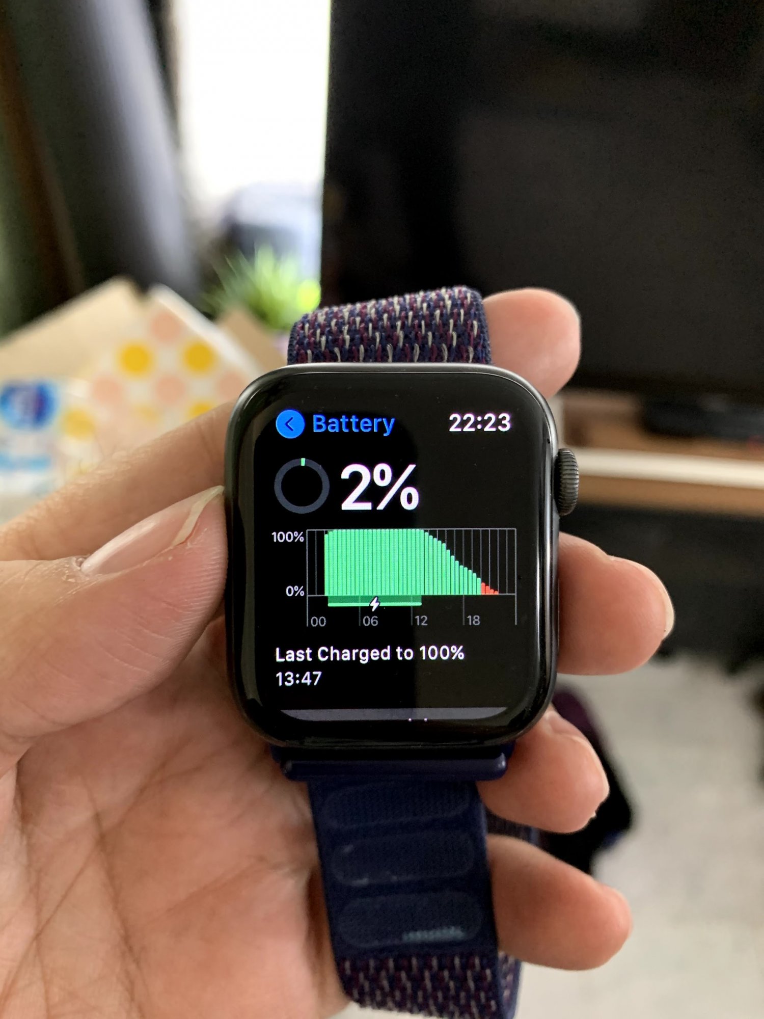

For easier comparison could we use the following format:
Model: S6 44mm GPS
Watch Face: Infograph with 8 Complications
Non-Default: Handwashing On
Workouts/Streaming: 75min Workout
Full Discharge or Partial Discharge Report: Full
Battery Life/Time:
0% Remaining after 21.6 hours = 4.6% per hour
Notes: This is the first full cycle after getting the watch. 1 ECG measurement
If AOD is off, please note under non-default.
Full discharge means until the watch dies. This is important because the actual percentage takes a while to calibrate... it’s common for a watch to get stuck at 100% for several hours, and/or totally die at 20-25% remaining because it hasn’t been calibrated properly.
Series 4 44mm Cellular + Watch OS 7 = 8 hours.
