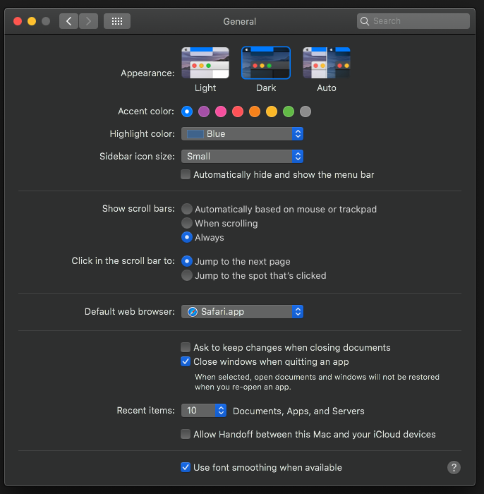

I attached a screenshot.
This is not a low Rez image.
Screenshot captured at 1440P.
Unchecking font smoothing helps a tiny bit and there's few other hacks that people use (not much difference if you ask me) but this is what a 1440p greets people with.
