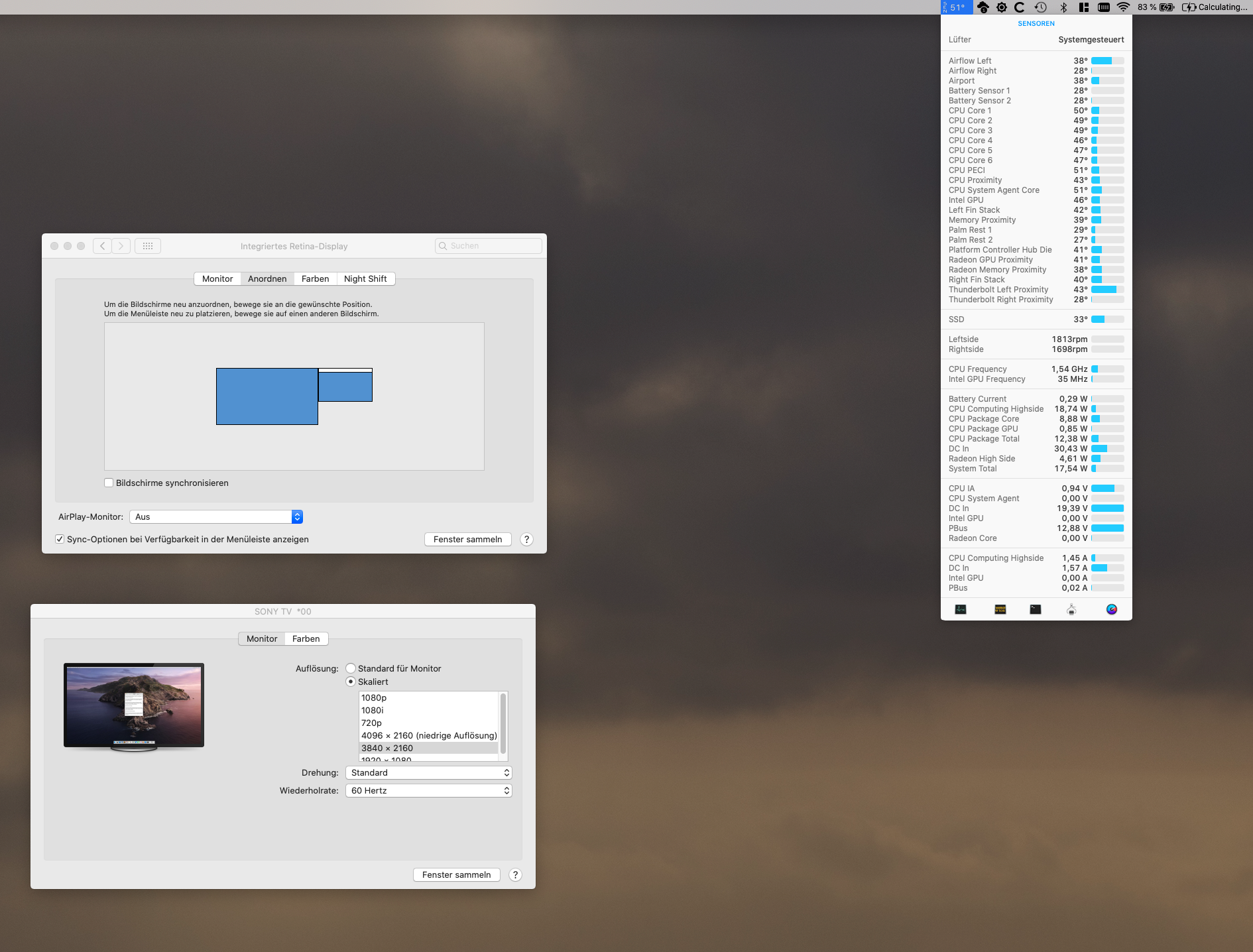

I could try the dock with a 4K display. Both for native resolution and HiDPI (looks like FHD) browsing, youtube, and CaptureOne for photo editing works perfectly fine. Mause and moving windows around works normal and smooth.
BUT: the fullscreen 4k 60FPS video playback using chrome is not as smooth as it was on the 1920x1200 screens. However it is still ok. AMD gpu power consumption still fine, as shown in the attached screenshot.

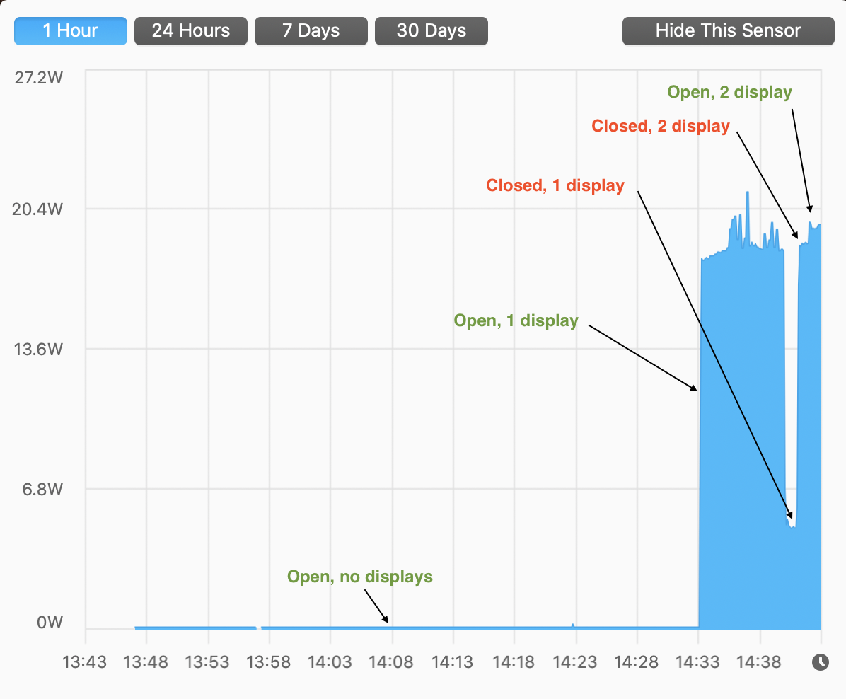

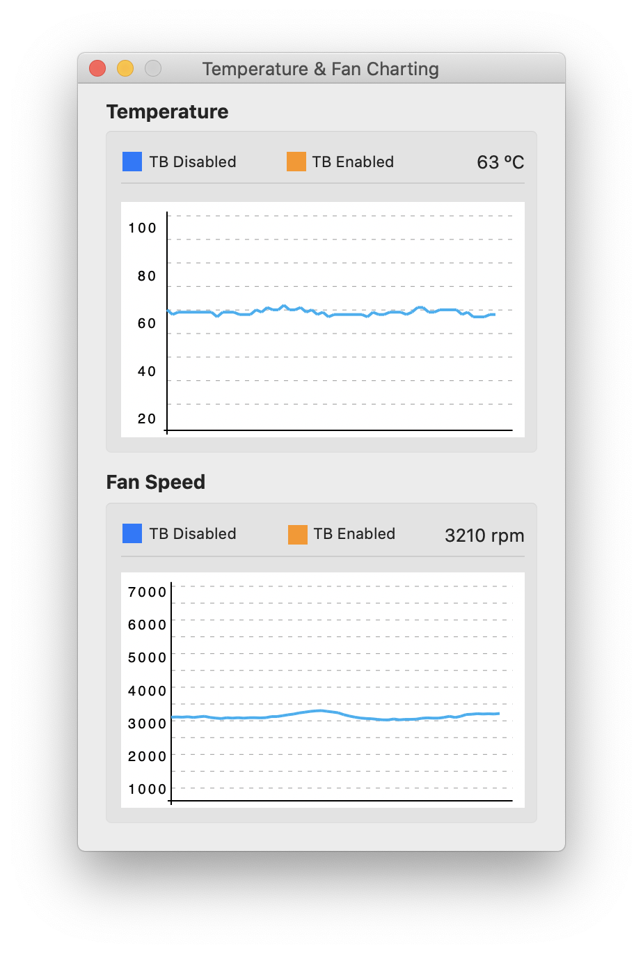

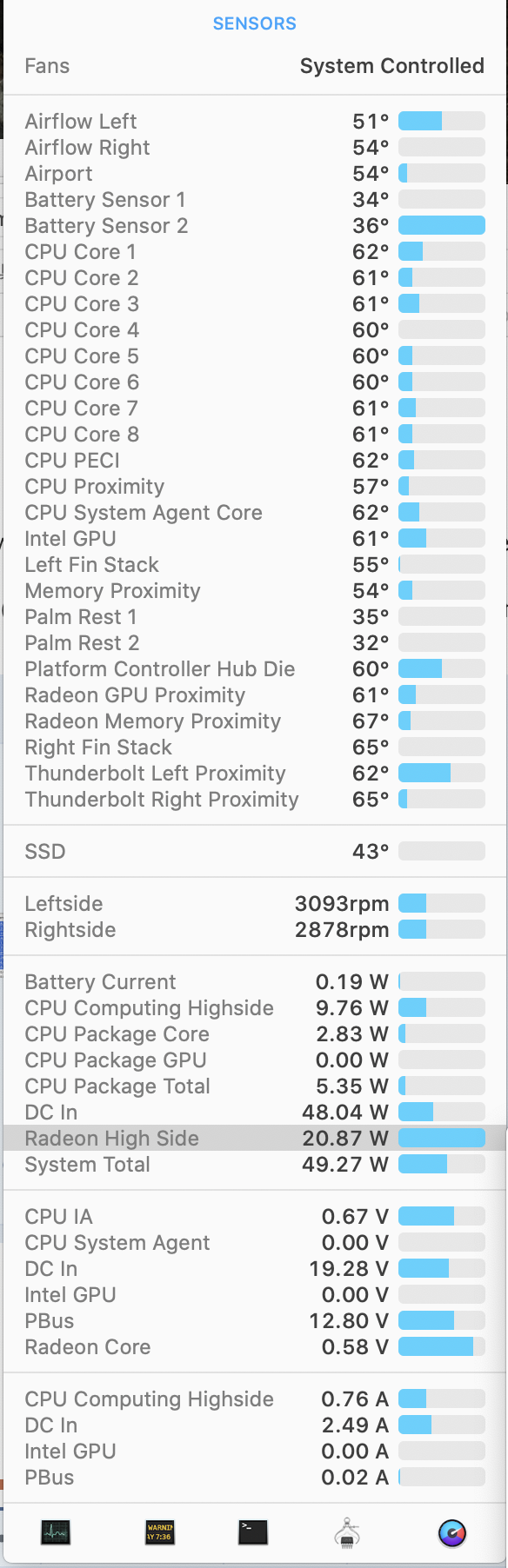

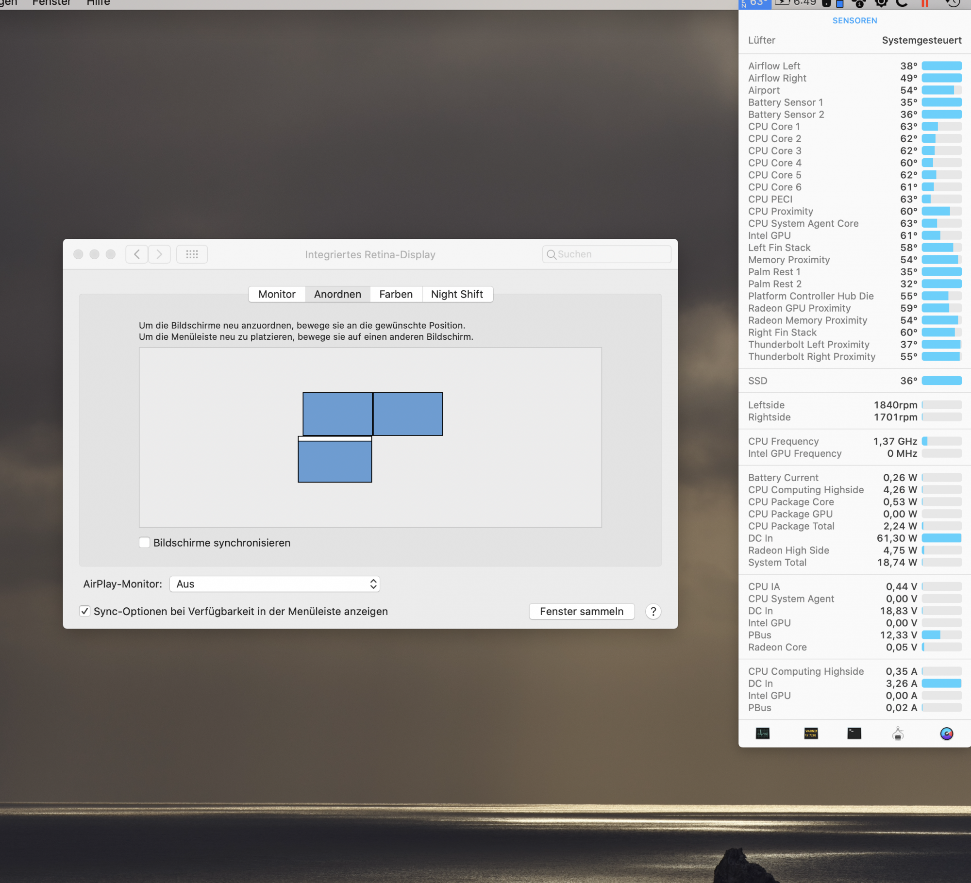

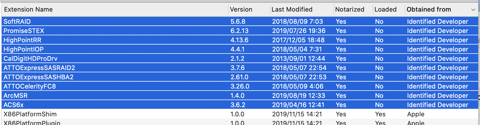

I have been contacting Apple for a long time, many hours on the phone, and many times chatting and back and forth. My case got escalated multiple times and eventually, it was considered a hazard case, after which the engineering department contacted me. But then it felt more like a facade, as they basically told me "it doesn't get that hot that the laptop shuts off, therefore it's not a hazard" and "this powerful laptop gets hot because it's powerful" etc. Finally, they recommended me to go to the Apple Store, but of course, here they just collect the laptop and conclude there is nothing wrong with it. So this took me a few months (bought the laptop in Nov. 2019).
I have the 16 inch, 2.4GHz, 32GB, 5500M 8GB, 2TB version and I am very pissed because it was expensive AF, and people in my work environment are annoyed by the loud sound, as it sounded like a small airplane was lifting off (fans up to 80-100%).
I use 1 or 2 5K LG Ultrafine displays, and because of the noise and the heat, I have not been using my displays anymore for the past half a year. Which is a shame.
I did, however, get some tips from the Apple Engineering guy on the phone, and I am not sure if these tips or the fact that I use TurboBoostSwitcher (set to off) are helping, but recently my fans are spinning at around 2700 (one display) to 3200 rpm (two displays), while at 1800 rpm without displays (all lid open).
Just to be sure, I will give the tips from the Apple guy on the phone:
- Go to About This Mac, and click System Report
- Go to Extensions under the tab Software
- Sort by Obtained
- Check the Not Signed ones and the Identified Developer
- Note the ones which are not listed in the "baseline"/normal list (see attachment) and find their location (you can find this following Location when clicking the extension which is not in the list)
- Go to that location (you probably have to use Option-click on the Finder's Go menu to see "Library") and instead of right-out deleting them, compress them (select the ones, and right-click and click Compress # items) so they remain in the same location but are not used by the system anymore.
- Reboot
Either this, the TurboBoostSwitcher or a combination of both have made my MacBook significantly less loud (as mentioned before 2700-3300rpm), however, it still draws ~20W from the Radeon High Side (see attachments).
Before this, the fans ramped up to 80-100%, while the Idle CPU (you can check it in Activity Monitor) was 90-98% (showing there was no real system activity which may have explained the high temp and the loud fans (which we all know did not, the fans ramped up to 80-100% even without any app open)).
1) No displays connected
2) 1x 5K LG Ultrafine
3) 2x 5K LG Ultrafine
4) list of extensions with "Identified Developer" which come with the Mac (don't delete (compress) these, but the rest).
5) iStat screenshot when 2 displays are connected (20W Radeon High Side, 2800-3100 rpm fans)
6) 2x 5K LG Ultrafine + TurboBoost enabled (after about 20 min)
Hope it helps somewhat. Now let's wait for a proper solution (driver update?!). In the meanwhile this made my life a lot better, hope it helps some of you too. Good luck!

It seemed to indicate these were not loaded. If you got results from this, what was the cause?

I’ve checked the kernel extension list, there’s nothing shady to remove.

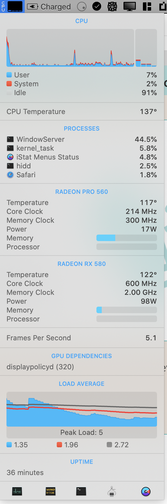

Guys,
I bought an eGPU (Radeon AMD RX 580) for my MBP 2017 and have 3 complains:
1) my dGPU consumes even more energy with eGPU than without it!
2) the dGPU does NOT stop working when I connect external monitors only through eGPU
3) only 2 monitors instead of 3 work with the eGPU (it can be because the 3rd one is like a tablet, but it works fine when plugged directly to my MBP).
4) the computer does not feel snappier at all...
The only good thing is that Radeon Pro is using only like 40% of its memory, as opposed to 100% without the eGPU, but that's not a tangible gain.
So have I bought a lemon? What can I do?

According to the users' feedbacks here, if you connect more than one external monitor, the issue still persists.
this really isn't the case for everyone. I had the temp issues in clamshell mode connected to only one monitor (a benq pd2500q) effectively a 2k monitor. didn't matter if I ran one or 2 in clamshell, my radeon high side wattage was near 20. so it is not a guarantee that single monitor in clamshell will solve the issue.
Attached is my case with the 5K LGs. Closed with 2 gives similar results as Open with 1 or 2 displays connected.
Indeed. Which means that even though one owns two displays, internal + external, one can activate only one of them and expect comfortable noise/wattage/temps.
So far it seems that the only way to reliably get comfortable noise/temp profiles with two (or more) active displays is eGPU + clamshell.
One of those ext displays can optionally be connected directly. All others via eGPU.
I’ve used Volta with 27 Watts limit for a week, Turbo Boost on. Three monitors attached without eGPU. RPMs run at 2800 idle, 4000 with web browsing and email.
That’s been decent, performance is great, but I’m still getting an eGPU for the 2nd and 3rd display.
Without it, the fans will easily max out, if the 2nd and 3rd displays are connected and the CPU gets a bit of work to do. I haven’t had any kernel_task slowdowns with 27W limit active, so that’s a positive. Heat management manages it, it’s just noisy. With 1 ext + clamshell it’s mostly quiet.
Interesting your fans go up to 4000 when you are doing only browsing. In my case growing and e-mailing with 2 monitors give me a Radeon High Side of ~20W, but fans to max 3000. Although for me as well if I do something more CPU intensive it also goes up to above 5000 rpm. What is Volta? And how does it help you specifically? Thanks

Guys,
Please describe how the things are connected.
You can only plug in the external monitors to eGPU. You shouldn't connect any other display to your laptop because it will trigger the dGPU for external display again.
Just tested after logging in from idle, RPM 2200. Ten minutes of news, some with video, and 3900 RPM, won't go over 4000 though. Spotify is playing, Intel Power Gadget and Activity Monitor are on. CPU load hovers at around 10%. If I stop interactions and only type here, it's now 3400 and going down. It will stabilize at around 3000...3400 when just typing, not moving windows or multitasking. Three monitors, clamshell. One of them 5k, two others WQHD.

I think people also confuse idle consumption with what the Radeon can spike to when you do literally anything with video while still in clamshell. I had a 16 that I returned and the fans were intolerable loud in clamshell whenever I played a video with a few other programs running. The problem was worse in the 5500m than 5300m but both were bad.
