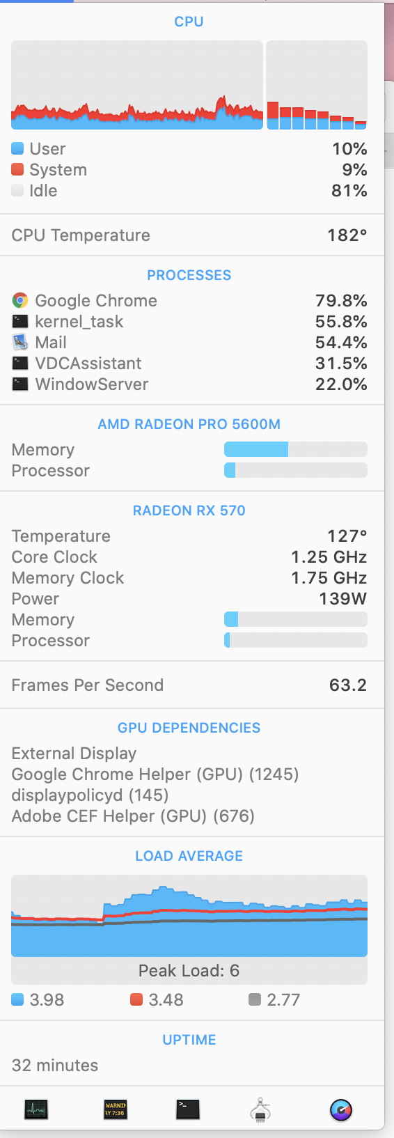

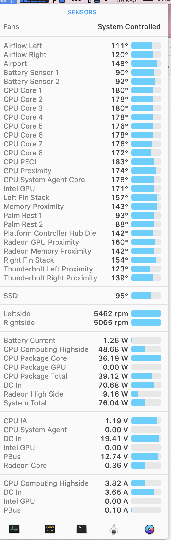

OK, for me at least, I have figured out that the 5600m creates much less fan noise unless I get chrome going. I have an egpu with running the second screen, the computer in clamshell with a UltraFine 27 as the first monitor.
My problem is that I run Ecamm which is a gpu hog and gets everything hot. I have that using the eGPU. However, no matter how I set it up, using google meet through chrome, which is the way I access online teaching, gets the computers fans to 100%.
So it seems that at least in my case, google meet and chrome is the main culprit. Perhaps there will be some updates to chrome, but at this point, I don't think my 5600 is working incorrectly.
Since you have an eGPU already, try setting the eGPU attached display as default so all newly launched apps use the eGPU.
Thanks - I’ve done that. But there there’s a pretty common bug that doesn’t allow chrome to reliably use the egpu. It’s seems that chrome is just a mess for macs
