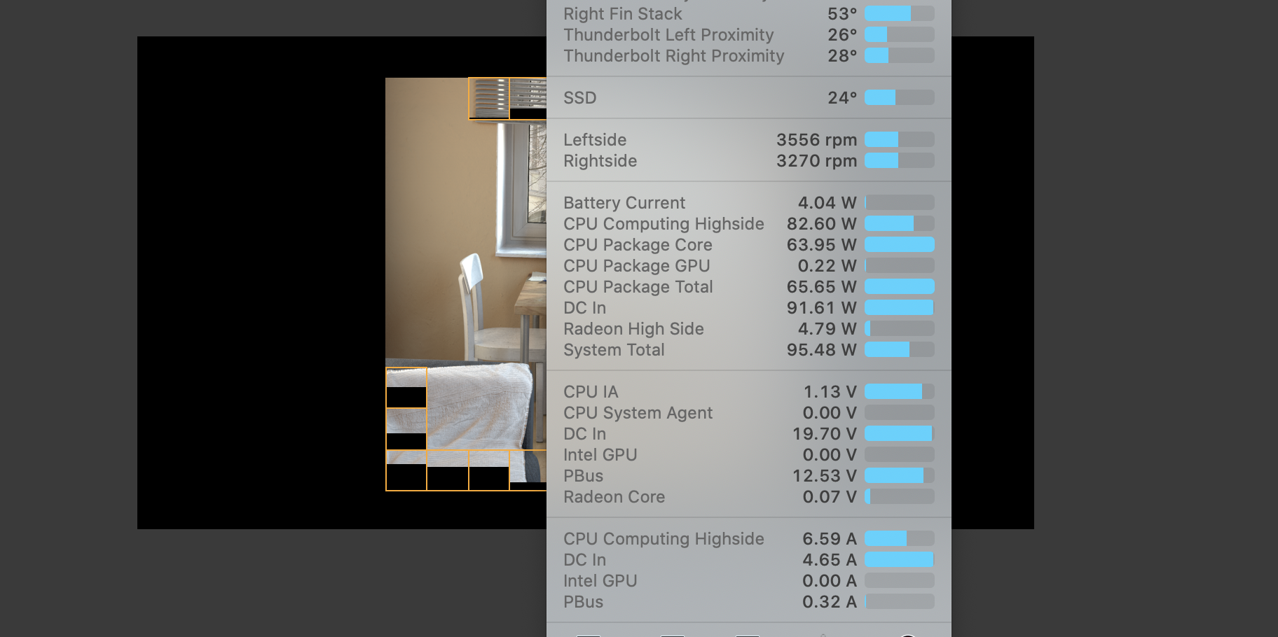

Not only did it fixed the VRM throttle which is heavily noticeable under high GPU and CPU load (e.g. Final Cut export), but it also reduced the fan noise for me.
I tried it for some hours now. Xcode (especially using its Interface Designer), AppCode, Discord and Safari are in use while listening to music. Before the mod, the fans would constantly sit at around 3k RPM and spike to full blast when compiling. Now the fans are sitting at 1800RPM and sometimes spike to 2200RPM and go back to idle after compile is done. Working in AppCode and Xcode (also Interface designer) doesn't trigger the fans.

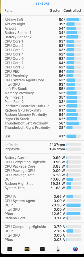

This is open lid with one external 4K monitor in HiDPI mode after a few hours of usage.
Of course it doesn't fix the high power usage, but the fans are quiet now.

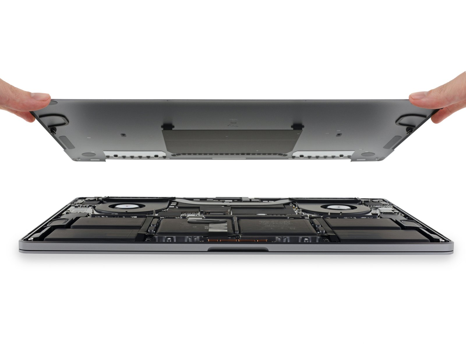

If you want to do the mod, watch a video how to open the case before you do that. Apple made it much harder to open the case compared the the pre-2016 Retinas.
thanks i've just bought the pads so im going to try this! Just found this video too
Yeah.. I also found that video. Do that and also put two layers on the TB3 controllers.
Combine this with a stand or anything that adds more clearance between the bottom plate and the surface below will give you enough cooling so the machine more or less never throttles.
Thanks, I already have a stand. Any tips for getting the back plate off? I have seen that there are clips on the right and left side and then its a case of pulling it forward away from the back, as to not dent the cover?
