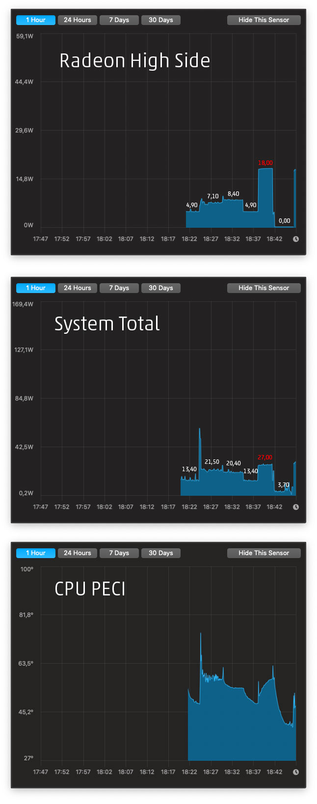

I don't think people don't know how electronics works. But looking at this specific use case when you connect an external display and the dGPU is consuming ~20W no matter if it's idle or under load is suspicious.
No, it isn’t. I believe 17w is the minimum that dGPU electronics draw. When using dGPU it’s not only the graphic processor that is drawing current, you have to account for dedicated memory too!
You're wrong because when using MacBook in clamshell mode the dGPU takes only 5W.
Radeon High side takes 4-5w with integrated panel on only. But check on iStat Menus the total energy on the CPU use section and you will be amazed... Its not 5W.
@pneves1975 is right. In clamshell mode the AMD dGPU uses around 18W when attached to a external monitor.
