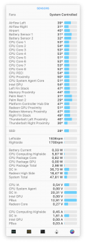

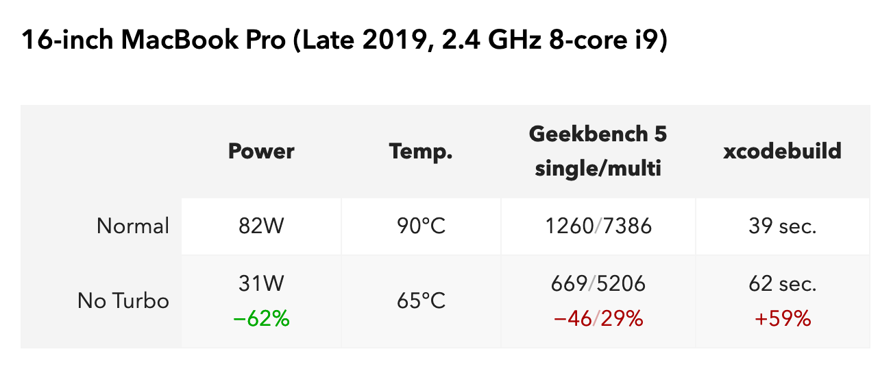

You could consider Intel "Turbo-Boost" as on-the-fly dynamic overclocking of your CPU without breaking its Thermal Design Point (TDP) boundary.
For example, 16" MBP-2019 machines sell with 2.3GHz 8-core Intel i9 processor with "Turbo-Boost" up to 4.8GHz, meaning that the CPU cores will operate at 2.3GHz most of the time, unless there's additional system load, on which event a CPU core could reach up to 4.8GHz to improve user's perceived performance, without frying the CPU/motherboard/logicboard due to the additional heat generated. A similar feature for AMD processors is known as "Turbo-Core".
>> Regarding this, are there any downsides to doing this?
To the best of my knowledge, there's no negative impact on hardware by disabling Turbo-Boost. In fact, it can save power, and thereby increase the battery life of your machine. Screenshot below from one of the linked articles above on thermal-impact results after disabling turbo-boost:

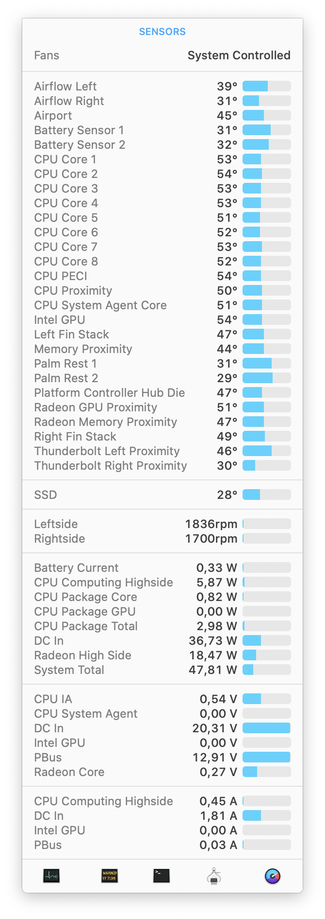

I got the 29UM69G-B (21:9) hooked up to my 16", in open lid mode no noise at all
Hi @Spartan23R,
This is really exciting result!

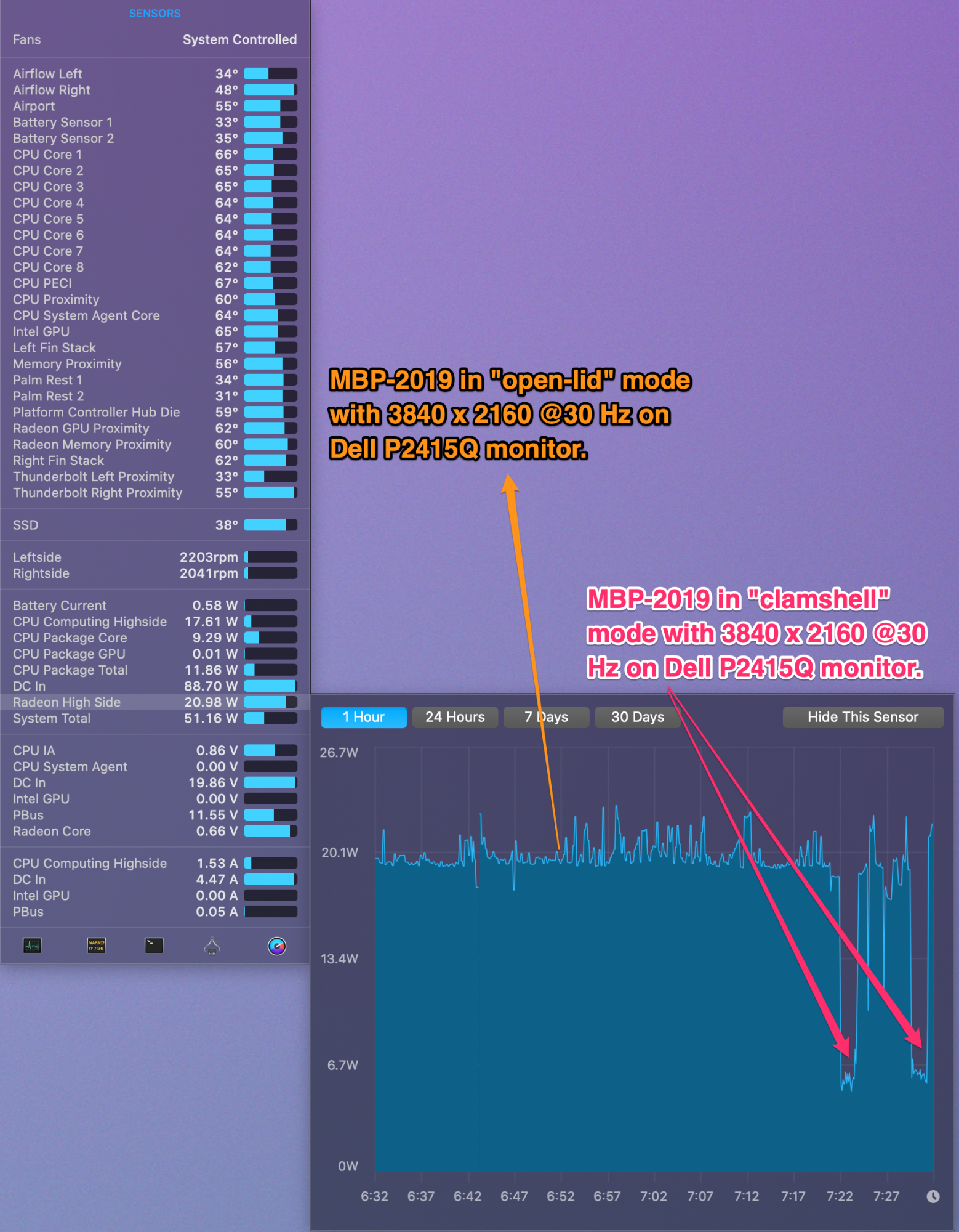

Could you please install iStat-Menus (free trial for 14 days) and post a screenshot like the following example. Please point your mouse to "Radeon High Side" line when you take the screenshot. It's one of the most important parameters contributing to extra heat (and fan noise) that the rest of us here are complaining about.
Thanks a lot.
## EXAMPLE SCREENSHOT
