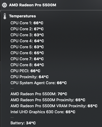

So... I recently saw something interesting. I regular boot into Bootcamp for some CAD software and to play Forza Horizon 4, and the other day my MacBook suddenly throttled very badly. CPU couldn't get past 1.7GHz and GPU would not get above 400MHz at all. Not even in Mac OS. Fans were audible all the time. Found out the culprit was my custom fan profile in Macs Fan Control messing up with the Mac OS side, and it persisted between each soft restart (switching from Bootcamp back to Mac). Eventually, the profile seemed to get "stuck" or something and fans were on full blast even when reported CPU temp was as low as 45 degrees Celsius.
I had to reset SMC 4 times before the fans stopped revving up to max at bootup.
Incidentally, that also seemed to have fixed many other issues... including weird battery health report and also the left side charging port getting uncomfortably hot. It's now about the same temperature as my CPU almost all the time.
And fans rev up to max properly when I'm rendering models in CAD or playing Forza Horizon 4, but then they die down to almost inaudible levels afterwards.
My ambient room temp is 26 Celsius right now, which is to say... not that cool, but CPU is reporting 52 Celsius, left Thunderbolt plugged into my display at 63 Celsius, and fans stay at around 1800RPM.
Even having the lid open and forcing 18W on Radeon High Side doesn't seem to make fans go up by that much, nor does it make the MacBook uncomfortably hot and loud like before.
So try resetting your SMC multiple times and see if that helps.

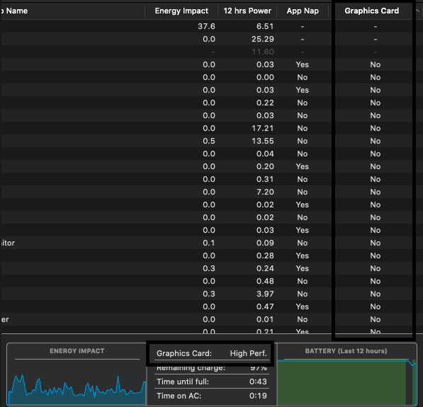

Check activity monitor CPU and share what’s going on there
I have done the following:
- Disconnected one of two external monitors I am using
- Downscaled my 2K monitor to 1080p
- Disabled hardware acceleration on Firefox.
However, even with all of those, my internal GPU is still running at max after looking at the Energy tab on Activity Monitor.

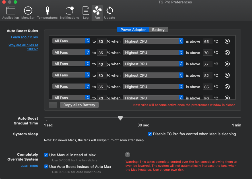

At the advice of a YouTuber, I installed TG Pro fan control and temperatures dropped from a blistering 90C to a more reasonable 65-75C with these fan curve settings. Fans don't go into overdrive anymore. Barely audible unless I'm doing some compiling.
Surprising that Apple has not addressed this yet. It's been months.
As long as you are using an external monitor, your MacBook will always use the "high performance" aka dGPU. It is not possible to run an external display using the integrated GPU. This limitation is hardware-based .... and it has been for years so this is not a problem of the 16" MBP.
