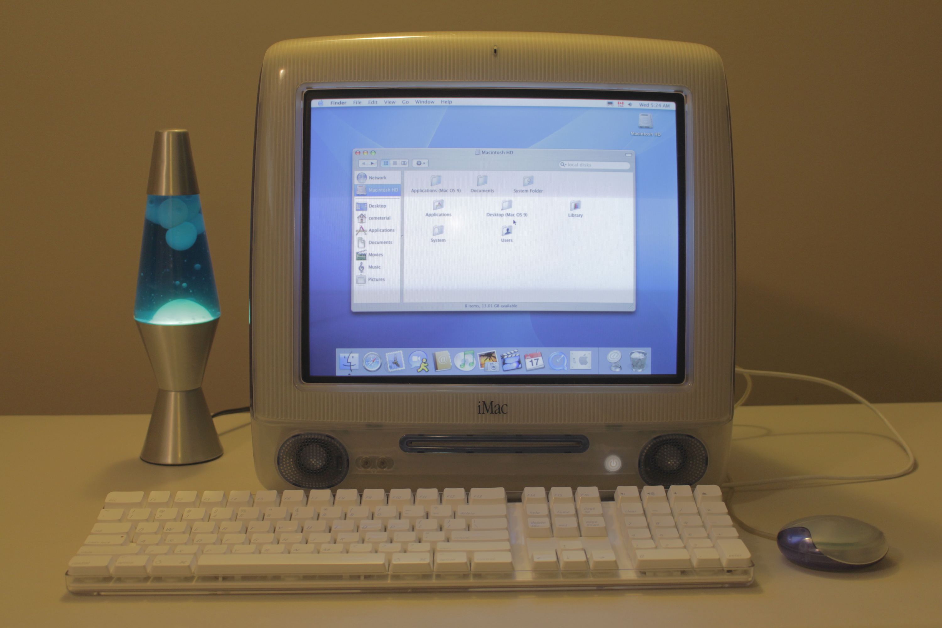

Well, I think I can finally say mission accomplished! 😎
I used my original Mac OS X Panther install discs and I've managed to install OS X alongside OS 9 without any problem.
(I would've installed Tiger instead, but I didn't have the original discs nor could I find the CD images online, so I just used the Panther discs I already had from another Mac.)
Here are some pics:
