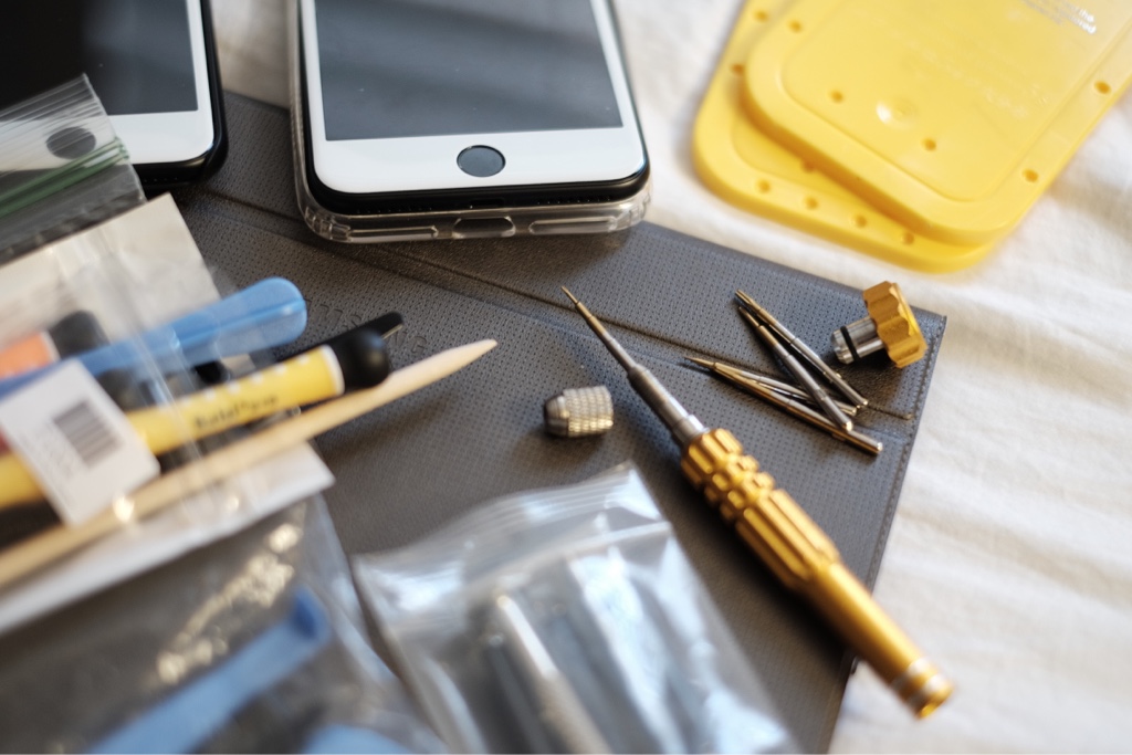

I tightened mine which was pretty loose and it only creaks one out of every 4 times or so when twisting and doesn't pop at all when pushing on the bottom right corner anymore. I'm waiting on a true pentalobe screwdriver instead of a torx head to come tomorrow and see if I can tighten the screws a bit more without stripping them.

You should not do that because of the water seal...
