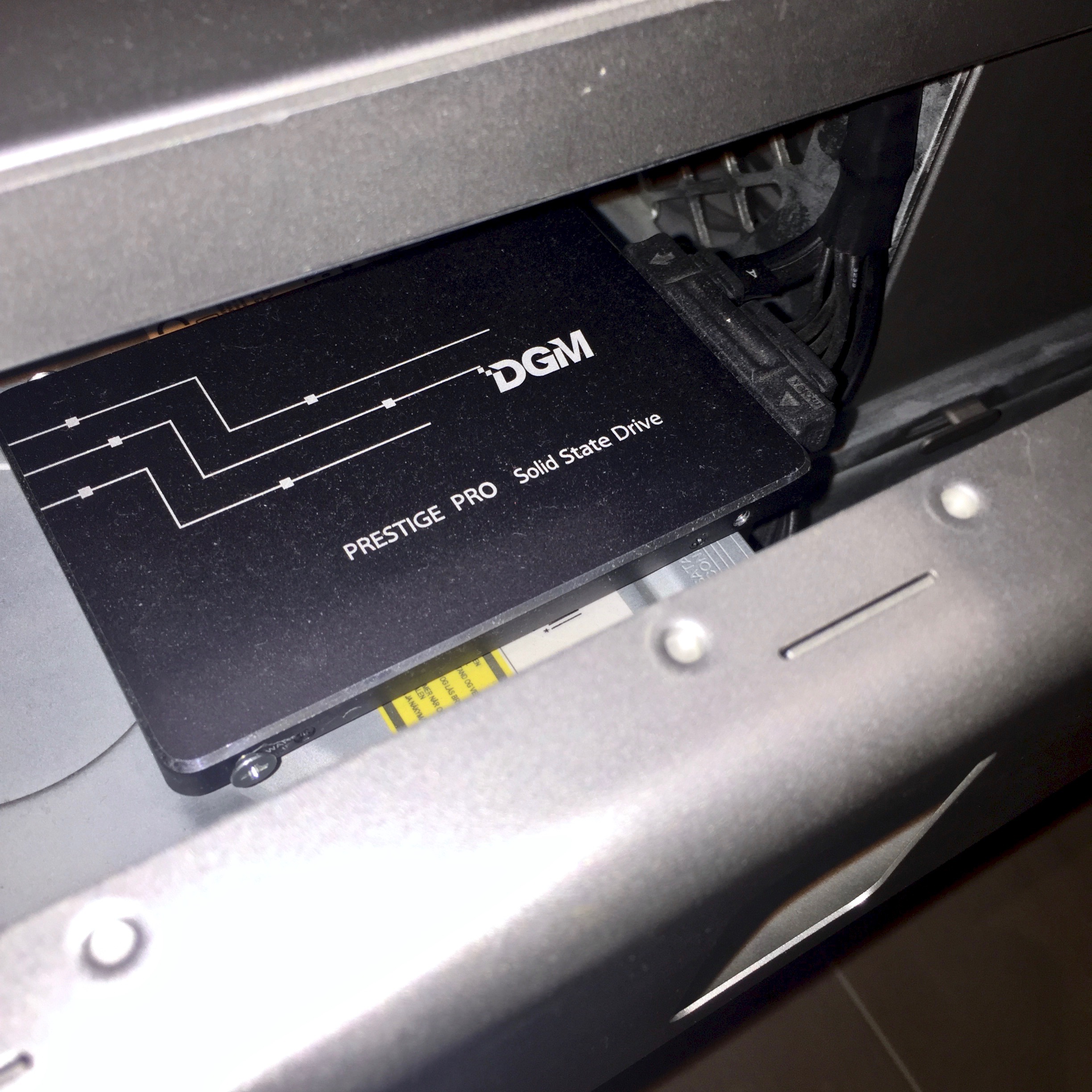

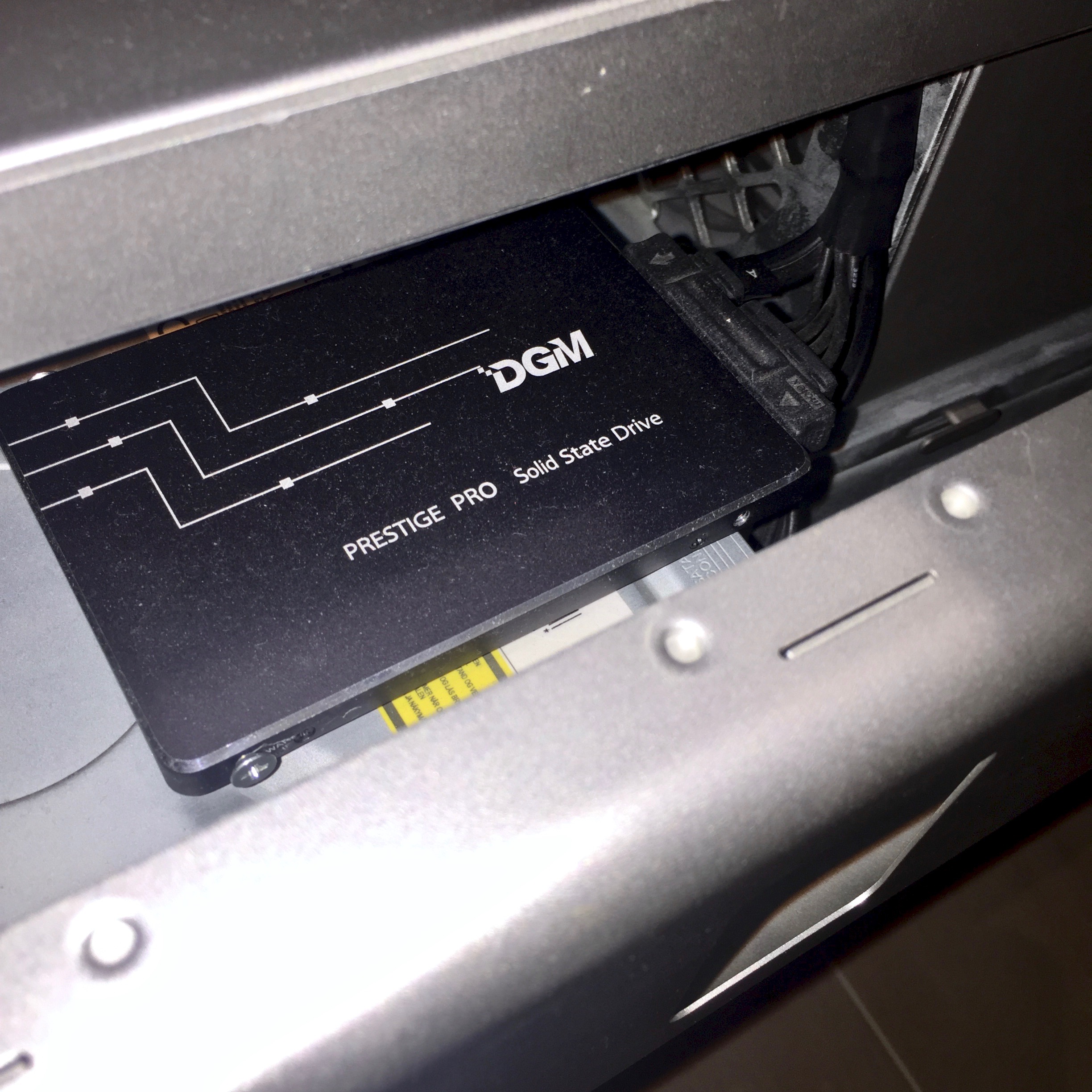

It's much easier to install the Windows SSD in the optical bay. Just plug the SSD into the SATA cable, leave it there, done!
My SSD sits on the Super drive, but it's totally OK to hang it below the Super drive. I've done that for a long time.
I am using a non flashed PC 1080Ti, the Tempo SSD card, and I can dual boot between Windows and macOS. Simply keep using HFS+ in macOS (but not upgrade to APFS), then use system preference to select Windows, or in Windows using bootcamp apps to select macOS as next boot drive. So easy.
Also, for your info. You don't need any remote control, Mac EFI, or another GPU to do the macOS / web driver update. I shared the detail procedure in here.

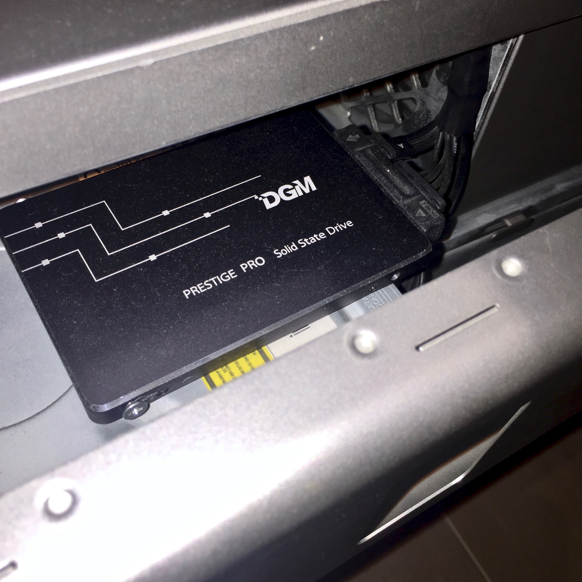

I know it's possible to unplug one of my EVO's and connect it to one of the sata 2 ports. In fact I got 5 slots for it since my two evo's (on PCI-E CARD) are the only storage devices installed.
- Guess that will be my only option to plug one of them into sata 2 and accept the slower read/write speed (I know It won't impact my performance in general because IOPS will be the same - Right?)
That way boot camp should work but you say I will have a problem using APFS (already installed OSX that way) ? ? ?
If I remember correctly it's because bootcamp isn't supported together with APFS at the moment ? ? ?
Not sure if that 970 is a good deal, not very familiar with that card.
Correct, IOPS won't be affected.
Correct, bootcamp apps cannot see the APFS partition. Therefore, it won't let you choose the APFS macOS partition as the next start up drive. If you have an OOTB card, then you can just perform a PRAM reset, this will bring you back to macOS. However, if you use a Nvidia Maxwell / Pascal card, this is not a good option at all, because a PRAM reset will also revert your driver selection back to Apple driver, which means your 970 won't work at all until you select Nvidia web driver and reboot (this can be done via remote control).
TBH, it's much easier to just clone the existing macOS SSD to another drive. Format the SSD back to HFS+, then clone the macOS black from the backup drive. And then use the bootcamp apps.
