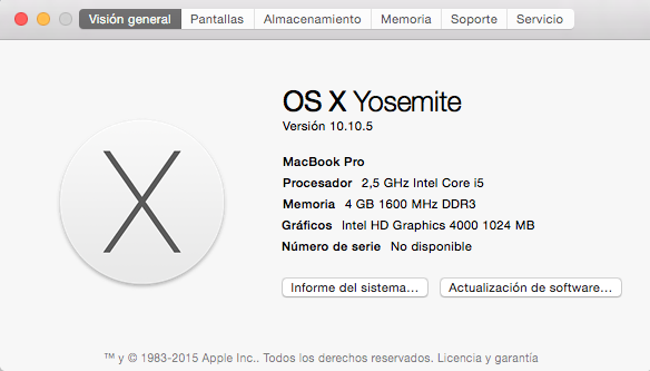

Hey there everyone,
I guess everyone on this forum has thought on upgrading it's Macbook Pro from whatever the amount of Ram it had to 16gb of Ram.
Well, last time I tried installing the 16gb everything went well... I checked if the computer was recognizing the ram and everything, which it was. Though the problem was, the minute I started using it, it started rebooting and giving me errors, pretty much 2 o 3 times a day. Went to mac online, they said that Mac says that this notebooks dont support that amount of Ram, wich in fact it is a false statement.
Came back home, T re installed the 4gb (2x2) and everything worked just fine.
Any thoughts on this? My mac is this one and it says it supports the 16gb
http://www.everymac.com/systems/app...re-i5-2.5-13-mid-2012-unibody-usb3-specs.html
Thanks!
