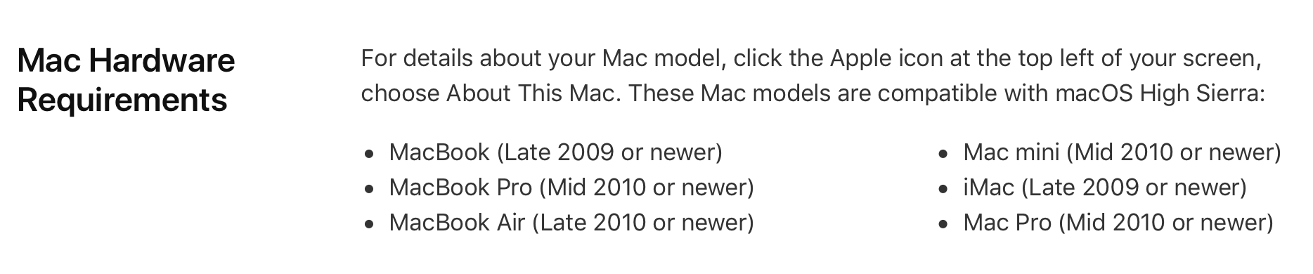

I wonder if the latest firmware update was intended to ensure that HS is the last macOS version for the cMP. I hope that’s not the case, but with the next OS around the corner the timing seems suspect.

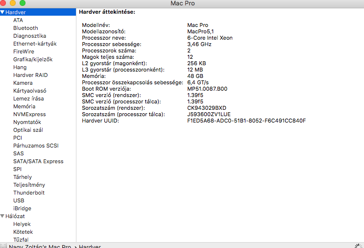

EDIT : I just found zozomester's post where his 'Hardware Overview' indeed does show his current bootROM IS . .. MP51.0087.B00

zozomester
Can you confirm that your current bootROM actually is MP51.0087.B00 bootROM ?
Yes:

I have to admit being sort of confused about the order of operations that you went through zozomester. So can you correct anything I got wrong here:
1. Running 10.13.4 and on bootrom 0085.B00 you flashed (using dosdude1 tool) a version of 0085.B00 with the NVMe driver injected. This allowed you to boot 10.13.4 from your NVMe drive
2. When 10.13.5 was released you installed it from the Mac App Store (meaning that your bootrom was unchanged and remained at 0085.B00) but after the install your cMP would not boot 10.13.5 from your NVMe drive
3. You flashed the stock bootrom 0087.B00 (by downloading and running the 10.13.5 combo updater). This resulted in still no ability to boot from NVMe
4. You dumped your 0087.B00 bootrom, injected the NVMe driver, and flashed it to you cMP, and you still cannot boot from NVMe.
Since you're the only one who presently has this problem (assume everyone else is too scared at this point to try it) it would be helpful to know the exact steps you took and in what order.

4. I dumped my 0087.B00 bootrom, injected the NVMe driver, and flashed it to my cMP, and still cannot boot from NVMe.
previously worked well with 0085.B00 previous version.
I don’t think that’s the case since the 2012 model is still supported. Has Apple ever denied an OS release to a still supported model?
