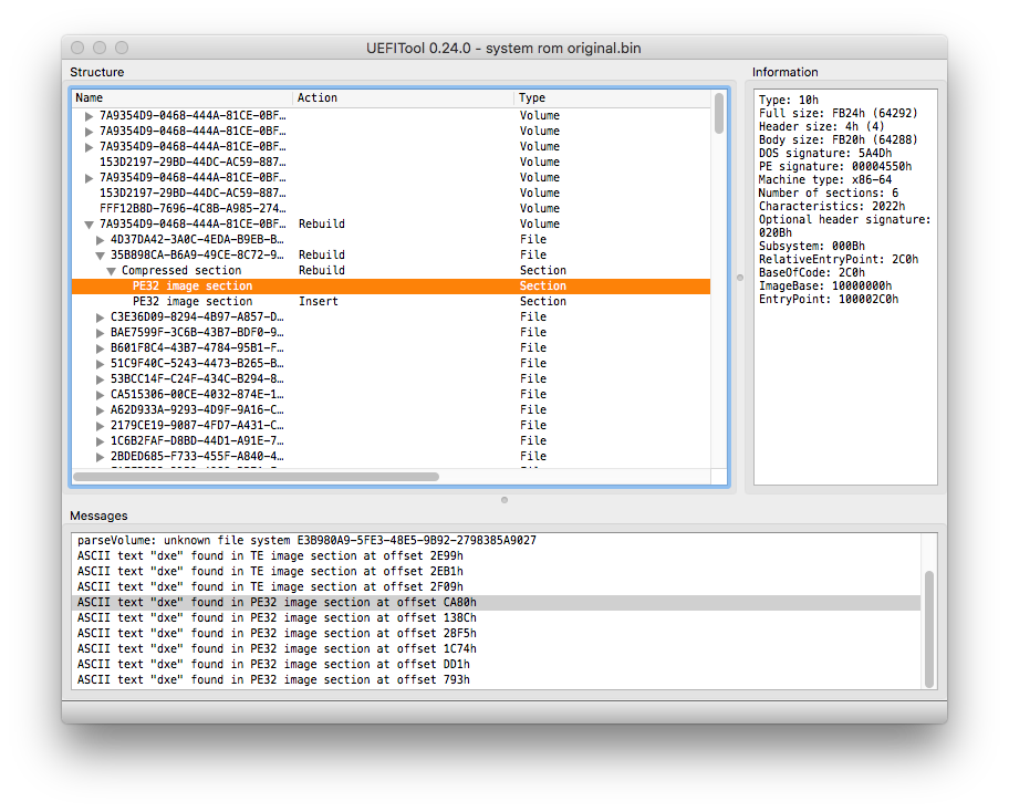

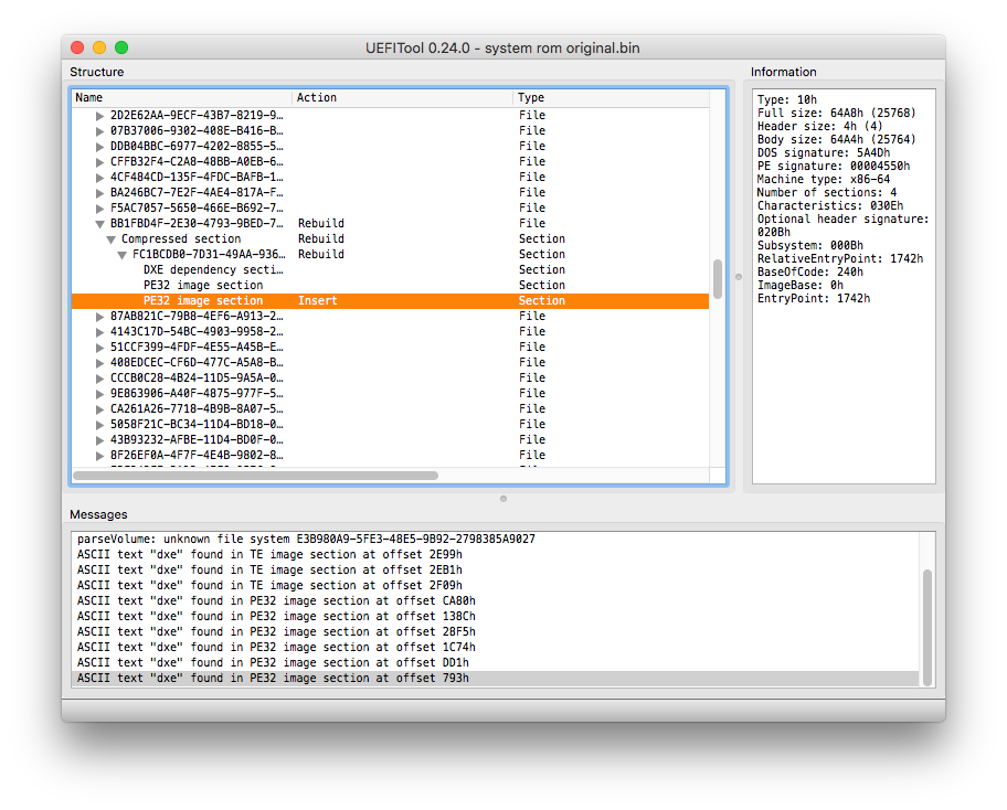

Somehow, the method from #13 didn't work for me. I tried both inserting the ffs after the last dxe in the rom at 0xca80 and after the last search result at 0x793 but after flashing using ROMtool, I don't see the 4k NVMe SSD (ADATA SX8200NP)
offered by the boot manager. I tried both CCCing my working install and the High Sierra installer.
What am I doing wrong?
EDIT: I also tried the DXEinject method from #175, still no NVMe SSD in the boot manager. :-(
