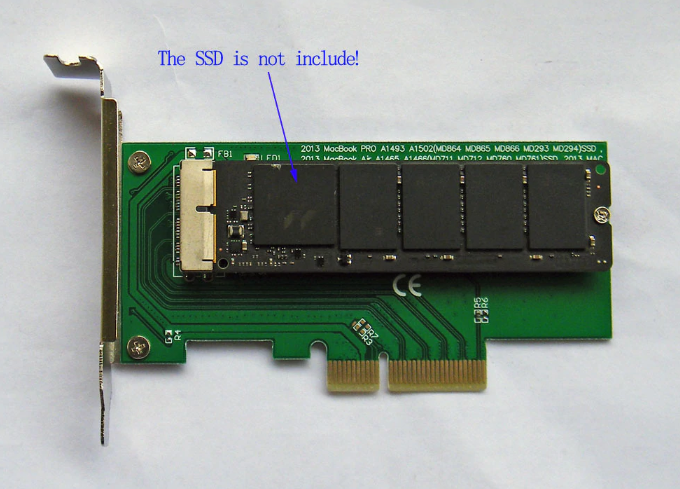

I’m talking about a pcie Adapter card to put the original Apple Mac Pro drive inside a cMP.
Like this or something else?
https://m.newegg.com/products/N82E16815287035
Reactions: flygbuss
Reactions: flygbuss
Thank you for correction. In this case I love to be wrong! Yes that looks like Apple stock SSD slot in the PCIe adapter card.
Thank you! I saw that card and was wondering if it would work. I was just wondering why the nMP was not mentioned in any advertisement or description.
Gonna order one of those!
It's only a adapter, and not a good one, but works nicely. I bought a heatsink install kit too, SSUAX/SSUBX works a lot better with heatsinks.

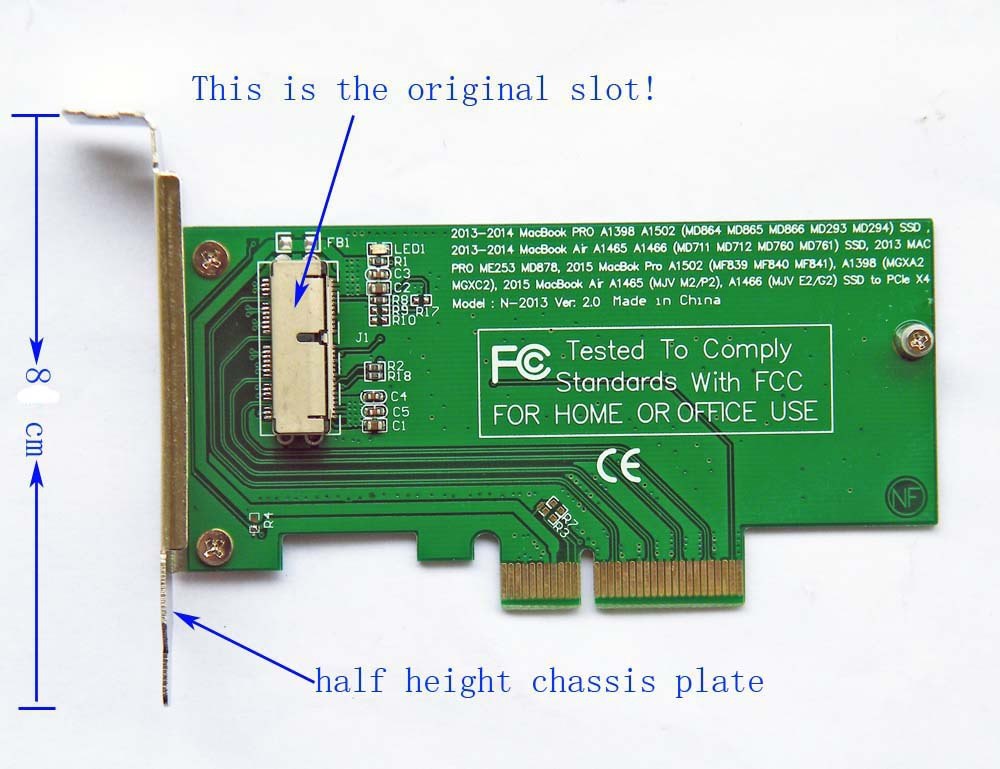

I've received the Sintech C adapter which I bought to upgrade my nMP from 256GB to 1TB.
But it occurred to me that perhaps I can transplant my 2015 MBP's 1TB SSD (655-1810) to the nMP and instead upgrade the MBP to a 2TB M.2 NVMe SSD with the Sintech adapter.
In principle, the transplant should not be an issue yes? Thanks in advance!
I used to switch the original SSDs from my MBPs (Late 2013, Mid 2014, Early 2015) to my nMP and vice versa: no issues at all.
Are there no sleep issues with such an adapter? It should be the following, https://www.ebay.it/itm/Sintech-M-2...459516?hash=item1a59209dfc:g:kq0AAOSwSrxbMVvt Is it correct?
Thanks.
[doublepost=1535397782][/doublepost]
Thanks for your reply. It answers my question on the viability of transplanting the MacBook Pro SSD to the nMP.
I've been following a parallel thread here on macrumors.com about using the Sintech adapter with nVME SSDs in MacBooks. As far as I understand there are definitely sleep/hibernation issues without patching the EFI on 2013-2014 MacBooks. In general, the larger effect appears to be on battery life due to the higher power draw of Samsung SSDs in particular. I've been considering the lower power draw Intel 760p 2TB which appeared successful for at least one user, although I might wait for the Intel 660p 2TB for a slower but lower priced alternative to the Samsung 970 EVO 2TB.
I ordered two of these long Sintech C adapters on Amazon and they were shipped directly from Sintech in China. They appear identical to the one you linked from eBay.
