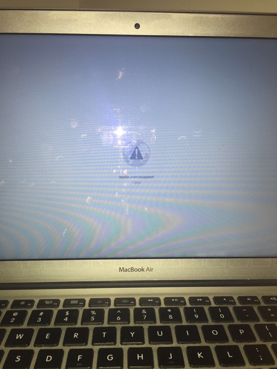

After about 10 min this appeared. No clue what it means
That 1005f error is usually because you are on a wifi network type that is not supported by Internet recovery. Try just completely disabling your wifi password and leave the wifi open for this and try again.
https://support.apple.com/en-us/HT201314
You can see what I am talking about halfway down this page under supported networks.
