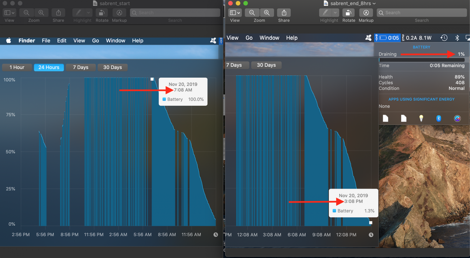

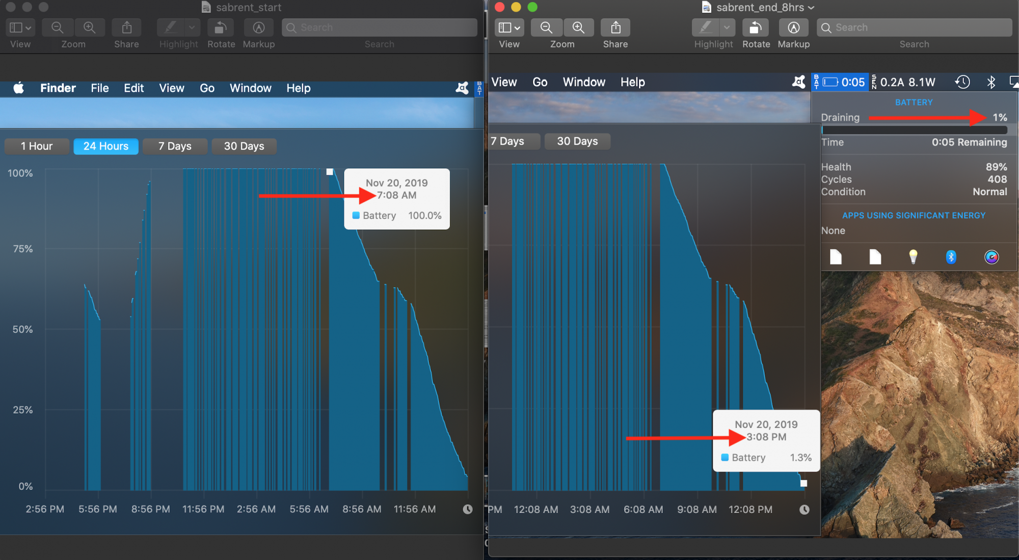

i was home all day and finally able to test battery life with Sabrent rocket 1TB MBP early 2015 13" (188.0.0.0) new bootroom, just basically browsing and watch a few youtube videos (50% screen brightness), for 8hrs not bad at all.
I find the Sabrent 1TB extremely variable with battery life. It's like a turbo car to me... if you baby it, then it doesn't suck the juice badly at all, but floor it everywhere and it'll be thirsty af.
If I'm surfing the web or watching netflix the Sabrent is fine. Not _quite_ as good as Apple SSD, but within 10-20%, so like only noticeable if you're thinking about it. However throw on Lightroom doing some heavy processing, Visual Studio in a VM, or both at once, and I've seen the battery go flat within 3 hours.
Thanks, one more question how good is that batt life compared to previous boot rom, did you notice any improvement?

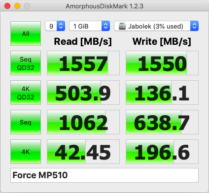

Corsair MP510 (512 gigs) on new (taped (neatly, must say)), long Sintech (?) adapter in early 2015 Air - running like a champ, temperatures are fine, battery got a bit of hit though (although did clean Catalina install and not sure if it's just macOS because iStat is showing pretty low energy usage figures for this drive...). Zero sleep or drain issues. I'm VERY happy (for now 😉 ).

Hi, how low are those figures? Could you attach some stats screenshots ?
Thanks
Thanks
Sure! This is what I can put right now (noticed that for example seq write can vary quite a lot from test to test (638 here to e.g. 890 - generally, drive is min. 2 times faster, prolly more). Catalina works very nice, animations are fluid even with 2nd monitor (1080) and lots of apps / windows...I'm pretty amazed that it still is my pretty little machine from 2015 😉
Please don't confuse link width (number of pci-express lanes) and PCIe generaion (version). Your SSD is using 4 lanes at PCIe 2.0 specs. One PCIe 2.0 lane equals to theoretical 500MBs throughput. PCIe 3.0 is twice as fast. Real throughput is always lower due to error correction and whatnot.
If your drive is formatted into APFS then yes. As far as I know HFS doesn't behave this way. Why? - no clue.
Thank you for your explaination, at least it's a jump from the 300 MB/s I was getting from the standard 129GB original drive.

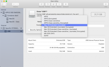

Is there a way to change from the APFS to HFS without losing data?
I don't recall seeing the option to select APFS when I formatted the drive.
Not completely sure since I haven't had a chance to go though this process personally, but I think the best course of action would be to make a time machine backup, re-partition the drive and then restore the backup.
As for filesystem it can be chosen upon erasing/partitioning the drive under "Format" drop-down menu. Mac OS Extended Journaled - is what you want.

I changed the hibernation mode, I no longer have this important battery loss
sudo pmset -a hibernatemode 25
It's not ideal, it should work with mode 3 on our models.
I don't really understand why other people said that it worked at the time with the same ssd model.
Reactions: fiftofar
Same here, just fitted an ADATA SX8200 Pro 2TB drive to a early 2015 MacBook Pro 13.
Clean install with Catalina 10.15.1 (19B88), Bootrom 188.0.0.0.0, SMC 2.28f7, no modifications to power settings except display sleep timer through energy saver preferences, no terminal commands run or anything like that.
Yesterday morning around 8:00AM (24/11/19) had 100% battery, did a reboot, disabled bluetooth, unplugged charger, closed the lid, opened it up this morning just before 8:00AM (25/11/19) and I was down to 15% battery.
I expected a hit to battery life but once it hits hibernate I thought the system was basically off.
