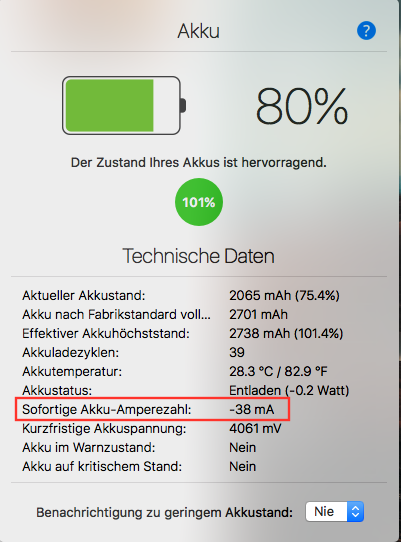

I checked my battery usage when the phone is in Standby and it seems like normal...
Yes when this bug happens usage and standby time are the same (settings -> battery) and the battery drains faster. A restart will fix it temporaly.
