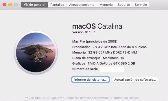

Yes, I told you. Mine works like a charm. Boot pressing ALT and see what volumes you have. Check the "Disable APFS booter" when making the USB if you already patched the ROM.
Thanks ******* :)
- Boot pressing alt --> ok i see my efi boot from my USB key created by Dosdude1
- Check the "Disable APFS booter" when making the USB --> this, i am not understand ? where ? when at the creation of bootable key ?
last question : what is exactly the process of "APFS Rom Patcher". May i see a progression bar or something elses ? because me only what i explain in message up #12,621

Hello, i have the same problem with Photoshop CC 21 cannot open it while photoshop CC 20 everything works fine.
Indesign -Illustrator- Acrobat works fine in CC21.
I have the same config than you. MP 3.1 2008 -GTX 680
